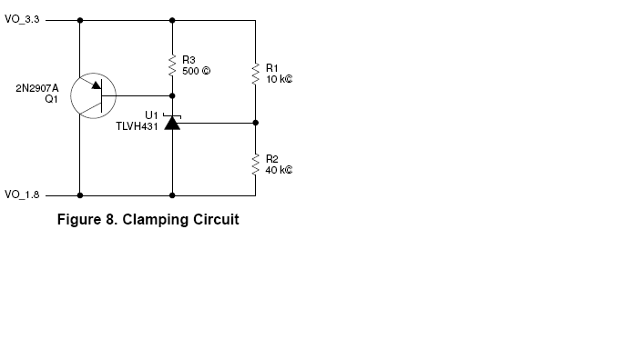

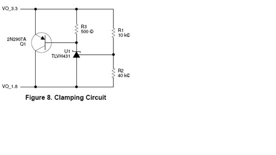

Use of a Clamping Circuit for Simultaneous Ramp Down
When using the ablve Clamping Circuit, because the 1.8V is power on first, the current from the 1.8V to the 3.3V:
(1.8-0.7)/500=2ma。Does the current affect the 3.3V of the CPU?
The Circuit is a Clamping Circuit for Simultaneous Ramp Down. But when am335x is power up, 1.8V is power first,3.3V is no power( equal to 0V)。So the 1.8V power is run from the TLVH431 and R3 to 3.3V. So the current is ( 1.8-V )/500. V is the positive of the TLVH431 . 500 is R3
According to the excerpt from the AM335x datasheet, the device must be powered on in the following
order:
1. 1.8-V Analog and I/O
2. 3.3-V Analog and I/O
3. 1.1-V Core
"The Voltage on 3.3V rail will follow the 1.8V rail with an 0.7 lower voltage." Is it not a problem?
