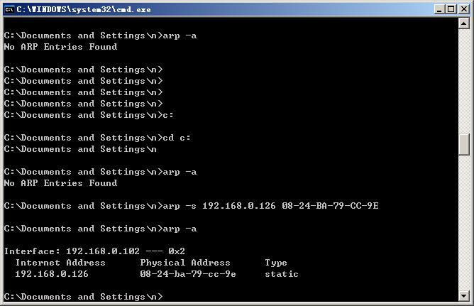

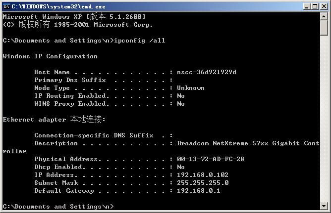

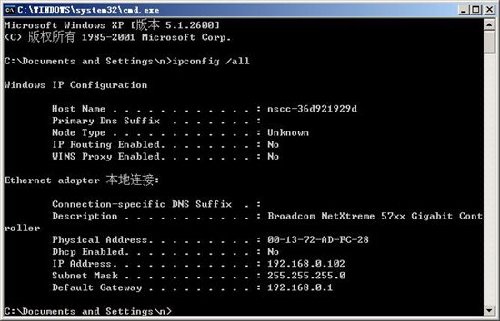

1. I choose the mode as ROM Ethernet Boot;
2. IP set as shown:
localIpAddress    = 192.168.0.126         # should be in the same subnet as TFTP server
localMacAddress   = 08-24-BA-79-CC-9E
serverIpAddress   = 192.168.0.102         # should be in the same subnet as DSP
serverMacAddress  = 00-13-72-AD-FC-28
3. tftp32d log as shown:
Connection received from 192.168.0.126 on port 32768 [16/10 19:20:22.390]
Read request for file <airshow_p352x288.yuv>. Mode octet [16/10 19:20:22.390]
OACK: <blksize=1460,> [16/10 19:20:22.390]
Using local port 16753 [16/10 19:20:22.390]
Connection received from 192.168.0.126 on port 32768 [16/10 19:20:33.421]
Unexpected request 5 from peer [16/10 19:20:33.421]
Returning EBADOP to Peer [16/10 19:20:33.421]
TIMEOUT waiting for Ack block #0  [16/10 19:21:57.421]
4. the result of running "arp -a" as shown:
5. the result of running "ipconfig/all" as shown:
I don't know why it report error.
could you help me?
