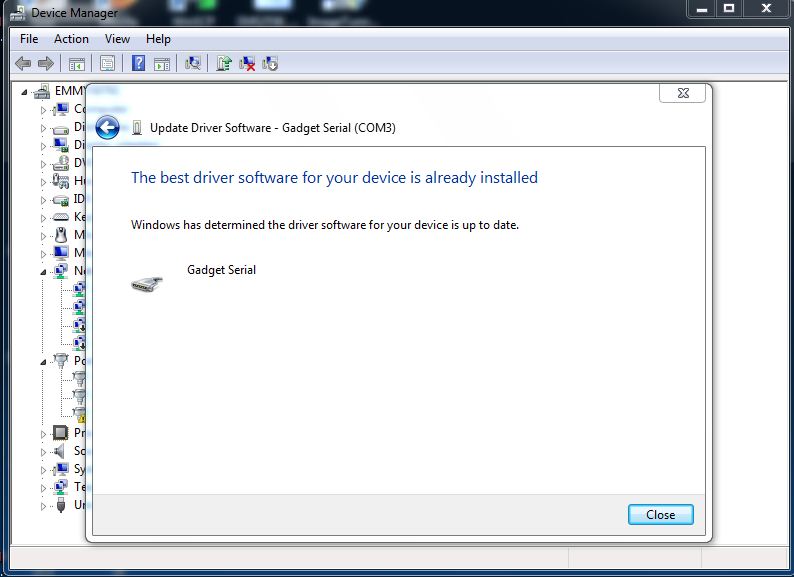

I have followed the instructions in the following URL to the T:
http://lxr.free-electrons.com/source/Documentation/usb/gadget_serial.txt?v=2.6.34
This document was also provided by Texas Instruments for their product TMS320DM365 which I use.
However, every time my device on the Windows XP PC side gets enumerated as a LibUSB-Win32 device and not as COM & LPT, as explained by the document. I wish to establish communication from gadget serial to windows host PC through USB CDC.
We have following configuration enabled for USB and serial:

  • We have enabled CONFIG_USB_ACM field
    I tried to install the USB driver accordingly, here is the list of outputs (please find attached)thereby displayed:
    1. On connecting the DM365 to PC, here’s what the device manager showed.(PFA->gadgetSerialInCOM_driverNotLoaded.jpg)
    2. On loading the driver by manually selecting a .INF file, here’s the dialog box shown.(PFA->attemptAfterLoadingTheDriver.jpg)
    3. Despite mentioning that the driver has been loaded successfully, the Gadget Serial (COM3) continues to show the yellow exclamation mark

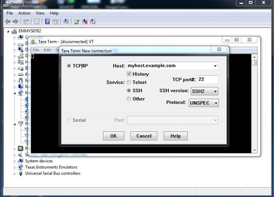

    4. Perhaps, this is why when I open Tera Term to access COM3, I am not able to access it. (PFA-> teraTermWontOpenCOM3.jpg)
    Could you please help us resolve this issue, as to how to make COM3 accessible after this?
