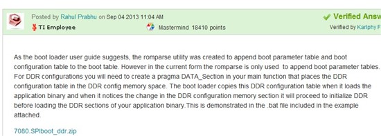

[QUESTION 2] NEW romparse utilities available?
You explained here the romparse is not available to append the boot config table, is there any new update?
http://e2e.ti.com/support/dsp/c6000_multi-core_dsps/f/639/p/288354/1006025.aspx#1006025
"As the boot loader user guide suggests, the romparse utility was created to append boot parameter table and boot configuration table to the boot table. However in the current form the romparse is only used  to append boot parameter tables. For DDR configurations you will need to create a pragma DATA_Section in your main function that places the DDR configuration table in the DDR config memory space. The boot loader copies this DDR configuration table when it loads the application binary and when it notices the change in the DDR configuration memory section it will proceed to initialize DDR before loading the DDR sections of your application binary.This is demonstrated in the .bat file included in the example attached."
[QUESTION 3]  How to  Config the DDR specified for 6670?
(Your example is not for 6670, and no documentation to refer to.)
The question is how to construct the DATA_Section , because I found the const BOOT_EMIF4_TBL_T  emif4Cfg={}  does NOT match the Bootloaser User guide(SPRUGY5B.pdf)
but unfortunately, SPRUGY5C.pdf totally cut this part, even if it claimed it is moved to the data manual ,but NOTHING updated to the 6670 data manual
Other users also rise this quesion:
http://e2e.ti.com/support/dsp/c6000_multi-core_dsps/f/639/p/288354/1006025.aspx#1006025 (see the last reply)
http://e2e.ti.com/support/dsp/c6000_multi-core_dsps/f/639/t/288236.aspx(see the last reply)
So ,which is the right DDR config struct?

  • Hi Frank,
    The device nomenclature is given in the data sheet in Figure 2-17.  If you don`t have the alphabet A between the part number and the package code (CYP) this is likely to be a silicon PG 1.0 version.
    One way to configure the DDR3 is by populating the DDR2 configuration table (bootEmif4Tbl_s) and load it as part of your application and place the structure  in the DATA_SECTION (emif4Cfg, ".emif4Cfg") as has been demonstrated in the example I shared with you. This process offloads DDR initialization to the boot ROM.
    If there are specific DDR initializations that the ROM doesn`t support you can use a second approach to perform this is by designing a 2 stage boot process where you boot into a main function where you configure the DDR and then re-enter the boot using the boot reentry address. When you renter Boot ROM , it will read not re-read the DEVSTAT or PLL settings but directly enter function to read the boot media and boot process.Your second stage boot can then load code into DDR space. To boot the second stage you will need to modify the read_addr_msw and read_addr_lsw in the SPI parameter table in the main function after configuring the DDR to read from the offset where you have written the second stage boot in your SPI NOR.
    For the second approach, the only example we have is the SRIO_DDRInit example in the MCSDK 2.x under tools/bootloader/examples/srio but it uses the IBL approach.
    Rahul
    PS: Please look at the reboot.c that I have attached. This was created for a 2 stage boot for ethernet boot but I have added some comments to elaborate the process.

  • Frank,
    I don't you'll ever get access to RBL and you can flash RBL, as its burnt to the BOOTROM. For any updates or fixes if available you'll have to take the newer silicon revision.

  • I spoke to a DDR expert on the team and it appears DDR3 chip config registers provide the seed values for DDR3 leveling which is necessary for proper DDR3 functionality. However, you can still get functional DDR without leveling at low speed bins like DDR-800, so for boot purposes those registers might not matter.
    We have ran test on C6678 without touching either the DDR Config registers or the RDWR_LVL_RMP_CTRL and RDWR_LVL_CTRL registers. Can you try to boot with DDR enabled by using a DDR-800 configuration and let us know if you are able to boot the device.
    ROM re-entry address is 0x20b00008 (look for the symbol _romtBootReentry in the map file).
    Rahul
