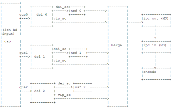

Hi all,
My env: dm8168 and dvr rdk 3.5
data flow:
part of usecase config:
    for(i_index=0; i_index<3; i_index++)
		deiPrm[i_index].inQueParams.prevLinkId = gVcapModuleContext.captureId;
    	deiPrm[i_index].inQueParams.prevLinkQueId  = i_index ;
    	deiPrm[i_index].enableLineSkipSc = FALSE;
    	if (adv7441_outparams[i_index].bInterlaced)
    		deiPrm[i_index].enableDeiForceBypass = FALSE;
    	else
    		deiPrm[i_index].enableDeiForceBypass = TRUE;
    	deiPrm[i_index].inputDeiFrameRate = 60;
    	deiPrm[i_index].outputDeiFrameRate = 60;
    	deiPrm[i_index].outQueParams[DEI_LINK_OUT_QUE_DEI_SC].nextLink = gVcapModuleContext.nsfId[i_index];
    	deiPrm[i_index].outQueParams[DEI_LINK_OUT_QUE_VIP_SC].nextLink     = gVcapModuleContext.mergeId[0];
    	deiPrm[i_index].enableOut[DEI_LINK_OUT_QUE_DEI_SC] = TRUE;
    	deiPrm[i_index].enableOut[DEI_LINK_OUT_QUE_VIP_SC] = TRUE;
    	deiPrm[i_index].tilerEnable[DEI_LINK_OUT_QUE_DEI_SC]          = TILER_ENABLE;
    	deiPrm[i_index].comprEnable = FALSE;
    	deiPrm[i_index].setVipScYuv422Format = FALSE;
    	deiPrm[i_index].inputFrameRate[DEI_LINK_OUT_QUE_DEI_SC] = 30;
    	deiPrm[i_index].outputFrameRate[DEI_LINK_OUT_QUE_DEI_SC] = 30;
    	deiPrm[i_index].inputFrameRate[DEI_LINK_OUT_QUE_VIP_SC] = 30;
    	deiPrm[i_index].outputFrameRate[DEI_LINK_OUT_QUE_VIP_SC] = 30;
		deiPrm[i_index].outScaleFactor[DEI_LINK_OUT_QUE_DEI_SC][0].scaleMode = DEI_SCALE_MODE_ABSOLUTE;
		deiPrm[i_index].outScaleFactor[DEI_LINK_OUT_QUE_DEI_SC][0].absoluteResolution.outWidth = 1920;
		deiPrm[i_index].outScaleFactor[DEI_LINK_OUT_QUE_DEI_SC][0].absoluteReso	lution.outHeight = 1080;
    	deiPrm[i_index].outScaleFactor[DEI_LINK_OUT_QUE_VIP_SC][0].scaleMode = DEI_SCALE_MODE_ABSOLUTE;
    	deiPrm[i_index].outScaleFactor[DEI_LINK_OUT_QUE_VIP_SC][0].absoluteResolution.outWidth = 1920;
    	deiPrm[i_index].outScaleFactor[DEI_LINK_OUT_QUE_VIP_SC][0].absoluteResolution.outHeight = 1080;
    	nsfPrm[i_index].inQueParams.prevLinkId	= gVcapModuleContext.deiId[i_index];
    	nsfPrm[i_index].inQueParams.prevLinkQueId	= DEI_LINK_OUT_QUE_DEI_SC;
    	nsfPrm[i_index].numOutQue	= 1;
    	nsfPrm[i_index].outQueParams[0].nextLink 		= gVcapModuleContext.mergeId[0];
    	nsfPrm[i_index].bypassNsf	= TRUE;
    	nsfPrm[i_index].tilerEnable	= TILER_ENABLE;
    	nsfPrm[i_index].numBufsPerCh	=  NUM_NSF_BUFFERS;
    	nsfPrm[i_index].inputFrameRate = 30;
    	nsfPrm[i_index].outputFrameRate = 30;
    mergePrm[0].numInQue = 2 * 3;
    for(i_index=0; i_index<i_dei_nsf_link_num; i_index++)
    	mergePrm[0].inQueParams[i_index*2].prevLinkId       = gVcapModuleContext.nsfId[i_index];
    	mergePrm[0].inQueParams[i_index*2].prevLinkQueId    = 0;
    	mergePrm[0].inQueParams[i_index*2 + 1].prevLinkId       = gVcapModuleContext.deiId[i_index];
    	mergePrm[0].inQueParams[i_index*2 + 1].prevLinkQueId    = DEI_LINK_OUT_QUE_VIP_SC;
    mergePrm[0].outQueParams.nextLink  = gVcapModuleContext.ipcOutVpssId;
    ipcOutVpssPrm.inQueParams.prevLinkId = gVcapModuleContext.mergeId[0];
    ipcOutVpssPrm.outQueParams[0].nextLink     = gVencModuleContext.ipcM3InId;
    ipcOutVpssPrm.numOutQue = 1;
    ipcOutVpssPrm.notifyNextLink               = TRUE;
    ipcOutVpssPrm.notifyPrevLink               = TRUE;
    ipcOutVpssPrm.noNotifyMode                 = FALSE;
    ipcOutVpssPrm.notifyProcessLink			   = FALSE;
    ipcInVideoPrm.inQueParams.prevLinkId       = gVcapModuleContext.ipcOutVpssId;
    ipcInVideoPrm.inQueParams.prevLinkQueId    = 0;
    ipcInVideoPrm.numOutQue                    = 1;
    ipcInVideoPrm.outQueParams[0].nextLink     = gVencModuleContext.encId;
    ipcInVideoPrm.notifyNextLink               = TRUE;
    ipcInVideoPrm.notifyPrevLink               = TRUE;
    ipcInVideoPrm.noNotifyMode                 = FALSE;
the input signal is 3CH HDMI 720P60
the problem is:
1) with the config above I see the 3 dei links' out is not normal:
DEI_LINK_OUT_QUE_DEI_SC 's output fps lower to 35
DEI_LINK_OUT_QUE_VIP_SC 's output fps lower to 26

and the second problem of the usecase is:
2) After several time(probably ten minutes or one hour) running, we cann't get the video bits from encode link(probably M3 is too busy to solve the data, I'm not sure)
Any body know why?
Is there any problem in my usecase config?
Any suggest to fix it ?
  • For the frame drop issue the bottleneck is not the DEI.
    1. I see the HDVICP load is not correctly shared across 3 HDVICPs with one being 97% loaded and another being 47% loaded. Make sure you correctly distribute across HDVICPS.
    2. Increase the number of DEI output buffers to 7 or 8.
    3, Check Enabling notify between ipcOutM3Vpss and ipcInM3Video and ipcBitsOutM3Video and ipcBitsInHost
  • Thanks for your reply.
    I just make the suggest 2、3 you mentioned, the DEI output is the same
    For suggest 1, I think you don't note my code
    I think the reason for HDVICP load is not correctly shared come from the DEI performace restrict, am I right?.
    and the more important problem is my problem 2) above:
    we find the different DDR frequence could cause the different stability from our long time test:
    1350 > 1600 > 1066
    the stability is the best when using DDR 1350, but when we lower it to 1066, the stability is not better than when using 1350, and the 1600 in-between
    Any suggest for problem 2) ?
