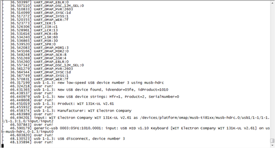

hi,
    we are using uart4 to receive data,at baud:921600. using ti-sdk-am335x-evm-06.00.00.00-Linux-x86-Install
    now we found that the uart missed some characters when playing sound and stop playing sound.
    now the question is:
    1 Does the driver Omap-serial.c  complate HW FIFO and DMA? how to open these feature?
     2 Is there any way to avoid missing characters at baud 921600
