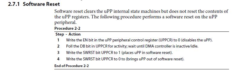

    For the software reset:
    The first step is to write EN=0 in UPPCR. So the software reset should send WAIT signal.
    Please have a look at section "Emulation Considerations" in UPP user guide.
    It says that uPP module (in receive mode) will assert WAIT signal if the stop-running conditions are met,
    which includes EN bit =0 in the uPP peripheral control register (UPPCR).

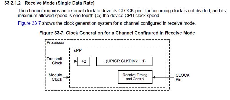

  • CLOCK - Driven by transmitter.
    In transmit mode, CLOCK is an output signal.
    In receive mode, CLOCK is an input signal.
    Software reset clears the uPP internal state machines but does not reset the contents of the uPP registers.
    UPP receive channel:
    The uPP peripheral will not drive ENABLE in receive mode, so the line should always reflect the value being driven by the FPGA.

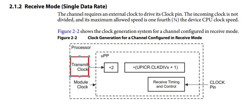

  • I had known that CLOCK is input signal in receive mode. So, FPGA drive the CLOCK signal when uPP is receive mode.
    The customer made following experiment.
     - uPP is receive mode.
    1. Data transfer completion from FPGA to DSP.    (FPGA does not drive uPP Clock when the data transfer is finished.)
    2. FPGA drive the uPP clock supply only.
    3. DSP perform the uPP Software reset processing.
    4. uPP register re-initialization    (2.6.1 Step-by-Step Procedure: run the step 5 or later)
    5. FPGA stop the uPP clock supply.
    6. Next data transfer from FPGA to DSP.
    It is OK if uPP clock is supplied from FPGA to the Softare reset process as described above. but, uPP can not receive the next data when uPP clock does not supply from the FPGA during the software reset. It seems that uPP DMA is not working.
    Shoud we countinue to supply uPP clock during software reset if uPP is in receive mode?

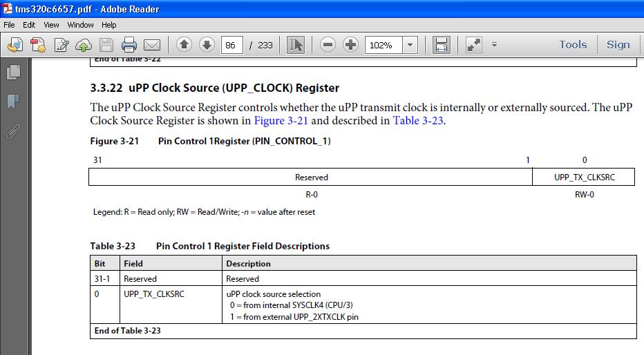

    Please kindly verify the UPP Clock register (0x0262016C) and refer the datasheet(tms320c6657.pdf)
  • Hi, Pubesh
    My custmor set to UPP_TX_CLKSRC = 0 and FPGA supply 70Mhz uPP clock to DSP, but Is there related to this register setting in uPP receive mode?
    So, I want to know following point.
    Q1: should FPGA supply uPP clock during software reset in receive mode?(Handling uPP clock during Software Reset is not described in the document)
    Q2: Is it should continue to supply How much uPP clock?     (Need until Software Reset sequence(2.7.1 Software Reset(SPRUHG9)) finished?)

    In general, any MMR based reset to work, the module needs to have a clock.
    So why you expect the SWRESET to work w/o the clocks being supplied?
    Thanks.

    I understood that uPP software reset must be supplied external clock in receive mode.

    I was thinking that software reset is uPP module's intanal state control, So I did not think external clock signal to affect.
    Because uPP initialization sequence after device reset out is running a software reset without the clocks being supplied, or uPP does not output clocks.
     <note>  Step 3 of Software Reset sequence  Refer to 2.7.1 Software Reset on SPRUHG9

  • Chi-San,
    You are trying to initializing the uPP peripheral and not resetting from your code snippet.
    Please refer the below sections at the UPP user guide(spruhg9).
    2.6.1  Section for uPP initializing
    2.7.1 Section for uPP resetting
    We can use the below code until unless hardware want to uPP get initialized.
    void uppdrv_internal_reset()
     UPPREGS.UPPCR.BIT.EN = 0; //disable uPP
     while(UPPREGS.UPPCR.BIT.DB == 1); //wait until DMA controller is inactive/idle.
     //uPP reset begins
     UPPREGS.UPPCR.BIT.SWRST = 1; //places uPP in software reset
     for(ii=0;ii<200;ii++);// wait 200 clock cycles
     UPPREGS.UPPCR.BIT.SWRST = 0;  //brings uPP out of software reset
     UPPREGS.UPPCR.BIT.EN = 1; //brings out of from disable mode (enable uPP)
    Here, Software reset clears the uPP internal state machines but does not reset the contents of the uPP registers.
    If the uPP peripheral is coming out of from POR, then can initialize the uPP(Refer the section 2.6.1).
    Otherwise better to use software reset code alone(Refer the section 2.7.1).
    Chi said:
    Please tell me my understanding that uPP software reset must be supplied external clock in receive mode is correct.
    Yes, you are correct.

    Customer board is connected to the AM1806 uPP and the A channel of C6655 uPP, It is used in bidirectional(A channel is switched direction during runtime). And the B channel of C6655 uPP is connected to FPGA, It is always receive mode.
    They need to reconfiguration uPP regitors. so the customer's resetting code is setting the uPP software reset and reconfiguration uPP registers.
    The code that I have attached above is  loopback configuration for testing code.
    I will check again to the customer the actual settings.
    As I had pointed out from you, Software reset can now be successfully by supplying external uPP clocks.
    I still have questions,
      Q1. Why software reset in uPP initialization sequences after POR is no need to supply the external uPP clocks?
      Q2. If uPP clock is not supplied from the external device when uPP is receive mode, Does uPP internal DMA not work, because of uPP internal state machines is not successfully reset?
