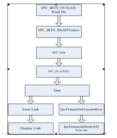

     Now,I want use the DM8168 to realize the function of "FileRead->decode->FileWrite ",first read .h264 file ,then decode the.h264 file ,i want save the decode data to a file  in A8 side.my DVR_RDK Vertion is " DVRRDK_04.00.00.03"  .
   i have some questions:
     1. now my link structure is
Ipc_bits_out_A8->Ipc_bits_in(vedio)->Dec->Ipc_Out(vedio)->Ipc_Invpss->Ipcframe_outvpsstohost->IpcframeInhost(or IpcbitInhost)
   i donnot know if the link is true .
    2.above the link structure i want to realize filewrite function ,how to get the data from link of  IpcframeInhost or IpcbitInhost .
    Thanks very much.

  • Link structure you have mentioned is correct. Last link should be ipcFramesInHost.

  • Hi Badri,
          Thanks for you replay.i have read the  post you have mentioned ,but i still cannot understand how  to get the decode output data.could you give me some advise.
          now i have  a question in the directory of DVRRDK_04.00.00.03/dvr_rdk/demos/mcfw_api_demos/mcfw_demo there some function to realize  the bit  file write function or frame write function.
           In the file of demo_vcap_venc_vdis_bits_wr.c the function  of Venc_getBitstreamBuffer() to get the bit buf data and write to the file .
          In the file demo_vcap_venc_vdis_ipc_frames_exch.c the function of  Vcap_getFullVideoFrames() to get the frame buf data and write to the file.
          But now ,from above link structure ,we donnot use the vcap,and venc,so i donot know how to get  the file write data .

           Above the following links i want to realise the FileRead->Decode->FileWrite Usecase ,i used it by follow link structure.
        Now,i have the following problems:
           i mearsue the recvived frames in IpcFramesInHost and IPC_IN(VPSS) side ,it only receive the first few frames of data but i use the demo of VdecVdis the link of IPC_IN(VPSS) can receive lots of the frame date .and attatched is the log txt mearsured in different link structure.
             I donnot know what the problem, Could you give me offers or sugesstions,thansk a lot.

  • Ensure you are freeing the buffers received in ipcFramesInHost back.

       Thanks for you replay ,after the link structure finishec ,i call a thread function  to write data to a file which is opened. and i consider the date is come from the  ipcFramesInHost  side.
     The main thread function and my commments are follows:
     VIDEO_FRAMEBUF_LIST_S bufList;
      while (FALSE == thrObj->exitFramesInOutThread)       //it will always run if the thread is start
        status =  Vcap_getFullVideoFrames(&bufList,0);  //it get a bit buf from the link of  ipcFramesInHost  side
       Vdectohost_ipcFrameFileWrite(&bufList);    //write  the frame date to file
        status = Vcap_putEmptyVideoFrames (&bufList);  //freeing the buf in the link of  ipcFramesInHost  side
         1. how can i do to free the buffers received in  ipcFramesInHost back.
        2. I think  the function of Vcap_putEmptyVideoFrames () realize  freeing the buffers received in ipcFramesInHost
    is that right.
        3. Between different link  what mechanism is based on the data transfer.
          Thanks a lot.
