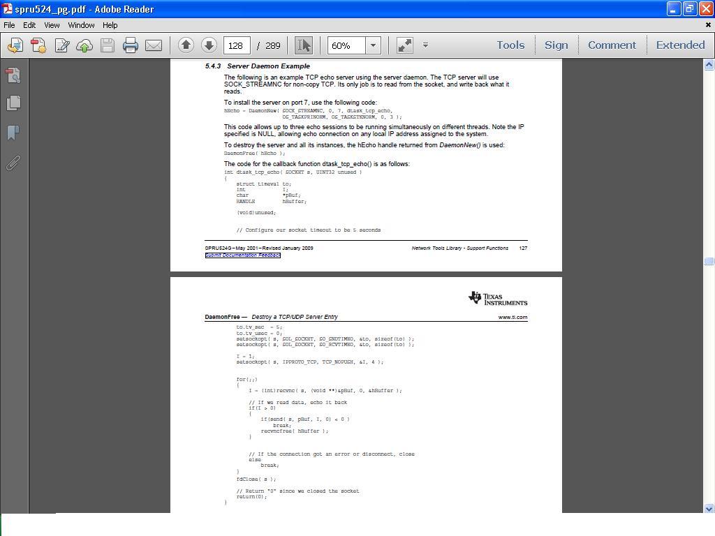

    When you disconnect the TCP socket, should be close the socket handle using fdClose.
    SOCKET slistenData = INVALID_SOCKET; //declaration
    If the connection got an error or disconnect, close the socket.
    fdClose( slistenCmd );
    slistenCmd = INVALID_SOCKET;
    You can find the EchoTCP in the section "Example Code" at TMS320C6000 Network Developer's Kit (NDK) Software User's Guide (spru523)
    And also refer the section "Server Daemon Example" at TMS320C6000 Network Developer's Kit (NDK) Software Programmer's Reference Guide (spru524)
