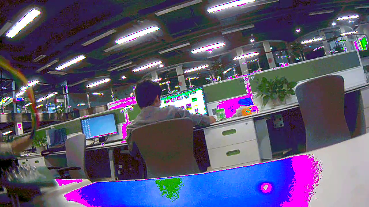

DM368+mt9p031_5M appears image colour problem
I use DM368+mt9p031_5M making IPC, software platform is IPC_RDK2.6.3, sensor board is layout by myself . The pictures of sensor board and video is below, please Ti engineer help me !
  • jun pan,
       I feel Colour configs are proper but Image is saturated!!.
    • Anyway check your ISIF-->CCOLP register value and make sure  colour pattern are set accordingly.
    • To check the saturation issue, check MSB of sensor input. It can be configured using ISIF registers. Please have a look at ISIF GAMMMAWD/modeset/ and corresponding registers.
      Same time you can share your sensor register settings here with me to have look at it.
  • Hi ,ravikiran:
               Many thanks to you,problem has been solved by changing other sensor board,it is probably welding because sensor boards have been welded by hand .
