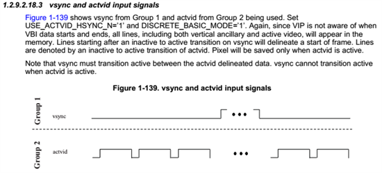

  • Hi Jeffery,
      Some observations from my side:
    1.        According to the VIP_PARSER_port_a register dump: 0x0040a114, is shown taking the FID from Pin, but I could not find the HW connection in their descriptions. I suspect the input is 800x600@60 progressive, so the FID should always ‘0’, and based on the register value, the value is from the PIN.
    2.       DISCRETE_BASIC_MODE is 1, that is Basic Discrete Mode, USE_ACTIVE_HSYNC_N is 1, which shown using the DE style line capture. Basicly, lines starting after an active transition on vsync will delineate a start of frame, lines are denoted by an inactive to active transition of actvid. From the test results they mentioned (50M clk or 27Mclk), the first point 0 was missed, so that means the VIP captured from the wrong starting.
    So, my suggestions are:
    1.       Check the FID pin connections, if it connect to the FPGA, make sure the FPGA output in FID pin is low, otherwise it is required to pull down. The VIN[0]A_FLD is internal pull-up active.
    2.       For ACTIVID HSYNC mode, the configuration looked fine, and they can check the waveform of clk, actvid, vsync, and Y/UV signals output, especially to check if the line starting from point 0.
    3.       Try to change the polarity of ACTIVID.
    Louis
