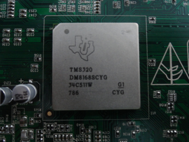

1.35 GHz for A8 is supported for CYG4. Refer data sheet.
Also, value of FRAC part seems to be wrong. How did you get this number?
Sivagamy Govindasamy said:1.35 GHz for A8 is supported for CYG4. Refer data sheet.
so what is the correct FRAC part number to set A8 work on 1.35GHz?
DM816x_FAPLL.xls present in DVR RDK release docs/UserGuides has steps to change frequencies. Please refer that.
Sivagamy Govindasamy said:DM816x_FAPLL.xls present in DVR RDK release docs/UserGuides has steps to change frequencies. Please refer that.
sorry ,I can`t find such .xls file in docs/UserGuides . My RDK version is DVRRDK_03.50.00.05. Is that file only provided in newer DVR RDK release ?
thanks
Its is present from ver 4.0 onwards. Check with your FAE to get DM816x PLL calculation sheet if you dont have dvr rdk release.
