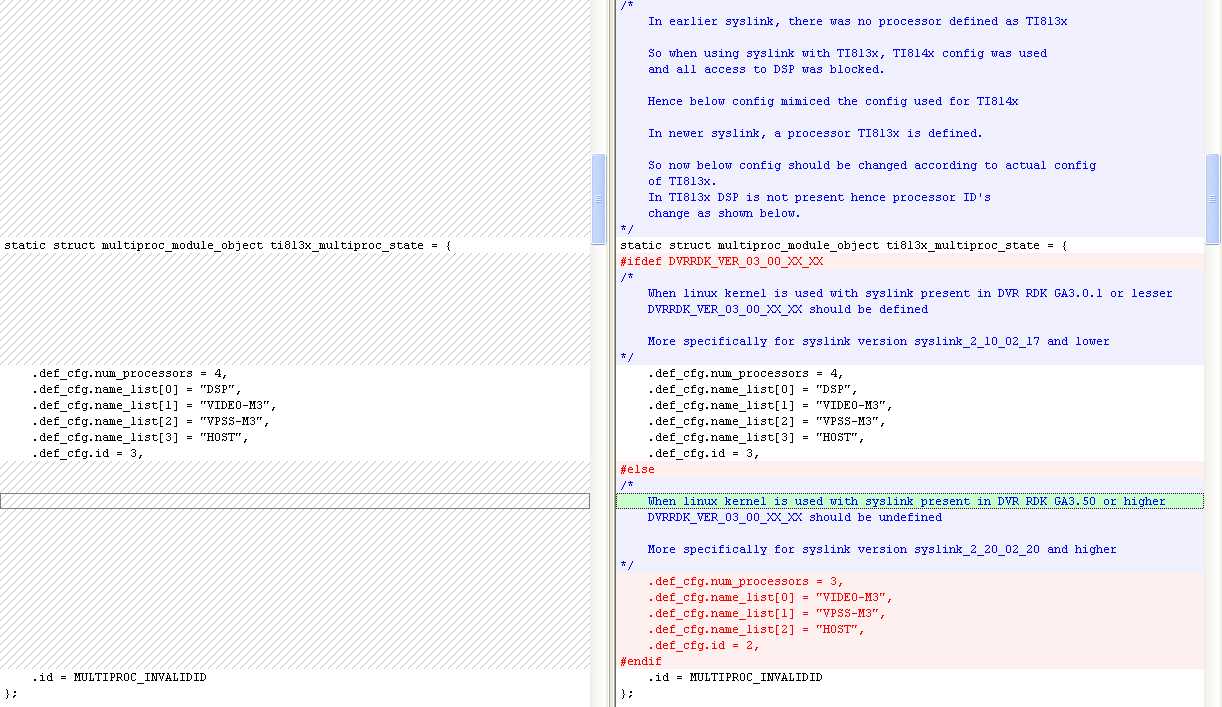

In runtime,I got an assert:
SAssertion at Line no: 2889 in /home/xxx/work/platform/20-cbb/platform/netra/ti_tools/syslink/syslink_2_20_02_20/packages/ti/syslink/utils/hlos/knl/Linux/../../../../../../ti/syslink/family/hlos/knl/ti81xx/Platform.c: ( Platform_module->hostModuleConfig.sharedRegionNumEntries == slaveModuleConfig.sharedRegionNumEntries) : failed
and the value of SR entries in host is 4.But in slave,it‘s a random value.
Does anybody know?
Thx.
  • When do you get this error. Is it during execution of ./load.sh ? Also what is your platform. Is it 816x or 8107. The issue will  typically happen if the number of shared regions is not the same across all the firmware like video M3/vpss M3 which is not possible if you are using DVR RDK without modifications. Other possibility is DDR is unstable on your board
  • When I load vpss firmware on 8107,I get the assert.
    I print the value when compiling the modified DVRRDK and the value is 4.
    I only modified the config_512M_128MLinux.bld and genaddrinfo.xs.
    Could you pls. tell me which section  the value saved in DDR.
    Attached is config_512M_128MLinux.bld and genaddrinfo.xs.

    When i used “insmod syslink.ko TRACEFAILURE=1” to get more debug info.,I get below info.What's .args section? Is that means  .data section?
    *** ElfLoader_load: Failed to write args! (ensure .args section is big enough)
    Error [0x0] at Line no: 1961 in file /home/chenwen/work/platform/20-cbb/platform/netra/ti_tools/syslink/syslink_2_20_02_20/packages/ti/syslink/utils/hlos/knl/Linux/../../../../../../ti/syslink/procMgr/common/loaders/Elf/ElfLoader.c
    [LINKS_API]: Loaded file ./../firmware/dvr_rdk_fw_m3vpss.xem3 on slave procId 2.*** Ipc_attach: SharedRegion_getPtr failed!
    Error [0xffffffff] at Line no: 460 in file /home/chenwen/work/platform/20-cbb/platform/netra/ti_tools/syslink/syslink_2_20_02_20/packages/ti/syslink/utils/hlos/knl/Linux/../../../../../../ti/syslink/ipc/hlos/knl/Ipc.c
    [LINKS_API]: Started slave pro*** Ipc_attach: SharedRegion_getPtr failed!
    Error [0xffffffff] at Line no: 522 in file /home/chenwen/work/platform/20-cbb/platform/netra/ti_tools/syslink/syslink_2_20_02_20/packages/ti/syslink/utils/hlos/knl/Linux/../../../../../../ti/syslink/ipc/hlos/knl/Ipc.c
    cId 2.
    [LINKS_API]: After Ipc_l*** Ipc_readConfig: Ipc not attached!
    Error [0xfffffff9] at Line no: 1166 in file /home/chenwen/work/platform/20-cbb/platform/netra/ti_tools/syslink/syslink_2_20_02_20/packages/ti/syslink/utils/hlos/knl/Linux/../../../../../../ti/syslink/ipc/hlos/knl/Ipc.c
    oadcallback status [0x00000000]
    Shared Region num host 4 slave 65132
    Assertion at Line no: 2889 in /home/chenwen/work/platform/20-cbb/platform/netra/ti_tools/syslink/syslink_2_20_02_20/packages/ti/syslink/utils/hlos/knl/Linux/../../../../../../ti/syslink/family/hlos/knl/ti81xx/Platform.c: ( Platform_module->hostModuleConfig.sharedRegionNumEntries == slaveModuleConfig.sharedRegionNumEntries) : failed
    *** Platform_startCallback: SharedRegion numEntries did not match with slave side
    Error [0xffffffff] at Line no: 2899 in file /home/chenwen/work/platform/20-cbb/platform/netra/ti_tools/syslink/syslink_2_20_02_20/packages/ti/syslink/utils/hlos/knl/Linux/../../../../../../ti/syslink/family/hlos/knl/ti81xx/Platform.c
    *** Ipc_control: Platform_startCallback failed!
    Error [0xffffffff] at Line no: 853 in file /home/chenwen/work/platform/20-cbb/platform/netra/ti_tools/syslink/syslink_2_20_02_20/packages/ti/syslink/utils/hlos/knl/Linux/../../../../../../ti/syslink/ipc/hlos/knl/Ipc.c

  • Are you using uboot from DVR RDK 4.0 release ? Can you check your DMM LISA setting match the uboot settings of DVR RDK incase you are using custom uboot.
    Share the log from uboot onwards.Also enable full syslin logs as below:
    insmod ./kermod/syslink.ko TRACE=1 TRACEFAILURE=1 TRACEENTER=1 TRACECLASS=3
  • 8080.full logs.log

    Customer run DVRRDK on DM8107.  They met similar issue above adding GRPX_BUFFER_SIZE . NO issue without GRPX_BUFFER_SIZE .  No issue on DM816x with same bld as following.  enclosd is the complete logs.
    Can you help to look into this?

  • Are you sure you have 1GB DDR memory on your board ?
  • Yes,Two piece of H5TQ4G63MFR.
  • Badri
    yes. it's 1G DDR.
    it run clean if we remove GPRX size as following.

  • In DM81XX_DVR_RDK_Memory_Map.pdf,It says that:
    A section of minimum 2MB need to be reserved for Syslink-Notify support in linux kernel. Linux kernel uses this
    memory to communicate with VPSS M3 in DVR RDK. Any change in address for this section requires an update
    of bootargs for “notifyk.vpssm3_sva” boot parameter
    But in dm810x config.bld,all NOTIFY_SHARED_SIZE = 128*KB.
  • 128 KB is sufficient. There is no issue due to that. At the time of clean and build dvr_rdk what is the value you get for prints below:
    *** TilerCfg:Total Size:  ?
    *** TilerCfg:8B Size:  ?
    *** TilerCfg:16B Size:   ?
    What is GRPX buffer used for in your application ? Are you mmap-ing the GRPX memory on A8 ?
  • We used GRPX for graphics  and mmaping the GRPX memory on A8 by /dev/mem.

    In RDK4.0, DM8107 belongs to DM813X,and in RDK 3.5 or lower,it belongs to DM814X.
    The picture below is the difference in muliproc.c in kernel driver between the kernel in RDK4.0 and my kernel.
  • Yes the procIds are different for 8107 because it doesn't have DSP. I hope you are using uImage that is part of RDK 4.0 and also you are compiling specifically for 8107 and not 814x.
  • Thanks  for your help!
    In my syslink  makefile,i forgot to modify the dm8107's platform to DM813X.
