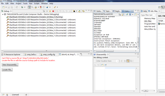

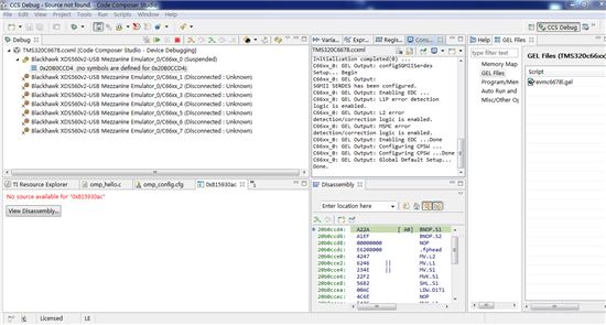

2. lanuch the target and connect core0,click "system reset".then load gel file on core0 and run the global default setup, disabled the "on a program load or restart", under "Auto Run     Options" on all cores
3. load program on core0 and load symbols on core1、 core2 、core3:
4. resume core0 and the console is:

Exception at 0x0
EFR=0x2 NRP=0x0
Internal exception: IERR=0x1
Instruction fetch exception
ti.sysbios.family.c64p.Exception: line 255: E_exceptionMin: pc = 0x00000000, sp = 0x00828eb8.
To see more exception detail, use ROV or set 'ti.sysbios.family.c64p.Exception.enablePrint = true;'
xdc.runtime.Error.raise: terminating execution
5. There is nothing i want to printed in console,then I click "resume" again but nothing is printed in the console:
Is the matter CTG versions? my CTG is v7.4.4,and my omp is 1.1.3.2.   I have search for this information,but i can complite it without error just no work.
This is not the result i wanted.. Any suggestion?
