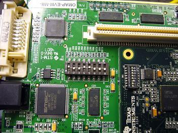

  • I do have a Samsung board, and I have tried the switch settings shown in the picture.  But to confirm, these aren't the same settings you sgguested earlier in the thread, correct?  The settings in the picture are SW4[8:1] = 11100110 = peripheral booting, USB>MMC1 correct?
    Also, I include the fdisk info and a file listing from my SD card.  Would you look it over and confirm that it appears OK?  Last, I had read some info on web about MLO having to be in the first sector of the partition - and the suggestion was to ensure that immediately after partitioning, copy MLO to the SD card before any other files are copied.  Do you have any sugguestions on how to guarantee MLO is in first partition, or how to verify that is actually is in the first partition?  Thanks.
    This is true, there are actually multiple combinations that can lead to booting from SD/MMC, I took the first settings from a Wiki site, the settings in the picture are what I had been using myself to boot from SD, unfortunately with the two board versions (Samsung/Micron) there are additional switch differences making it overlycomplex.

  • Just another follow up, I think the EVM hardware manual might show the SYS_BOOT pins backwards since it shows SYS_BOOT0 with SW4-1 and SYS_BOOT1 with SW4-2 and so on, but based on my switch settings I believe it is actually the reverse.
    What exact SW4 setting is getting you the 'X-Loader hangs' message? I tried a SW4[1:8] of 11100000 and got the 'Texas Instruments X-Loader 1.41' but no hang message, it just did not do anything else, setting SW4[1:8] to 00011100 left nothing printed on the terminal.
  • I don't think the EVM HW manual is wrong.  Maybe just confusion between you and me?  Note that the order you and I are showing for the bits is reversed from how it's shown in TI TRM.  So, ignoring SW4[7:8] per the EVM HW UG, here are my results for the following settings:
    SW4[1:6] = sys_boot[0:5] = 011001 = OK (in TRM order sys_boot[5:0] = 100110)
    SW4[1:6] = sys_boot[0:5] = 011000 = OK (in TRM order sys_boot[5:0] = 000110)
    SW4[1:6] = sys_boot[0:5] = 011100 = hangs after "Texas Instruments X-Loader 1.41  X-Loader hangs" (in TRM order sys_boot[5:0] = 001110)
    SW4[1:6] = sys_boot[0:5] = 101101 = hangs after "Texas Instruments X-Loader 1.41  X-Loader hangs" (in TRM order sys_boot[5:0] = 101101)
    SW4[1:6] = sys_boot[0:5] = 011101 = hangs after "Texas Instruments X-Loader 1.41  X-Loader hangs" (in TRM order sys_boot[5:0] = 101110)
    SW4[1:6] = sys_boot[0:5] = 000111 (and most other valid settings) = hangs after "Texas Instruments X-Loader 1.41" (this is what you reported has showing nothing?)
  • After running through your settings and some contemplation I belive I found my confusion, the dip switches are effectively inverted, i.e. turning on a switch pulls that pin low, not high, so it is not that the pins are marked backwards it is that they are of the opposite value, confirmed by the schematic. I apologize for this confusion, I should have checked the schematic to begin with. Taking this new finding into account I went through the SW4 settings you suggested:
    Same. Just so we are clear, taking the inversion into account, this setting is what the picture posted in an earlier thread shows.
    Same
