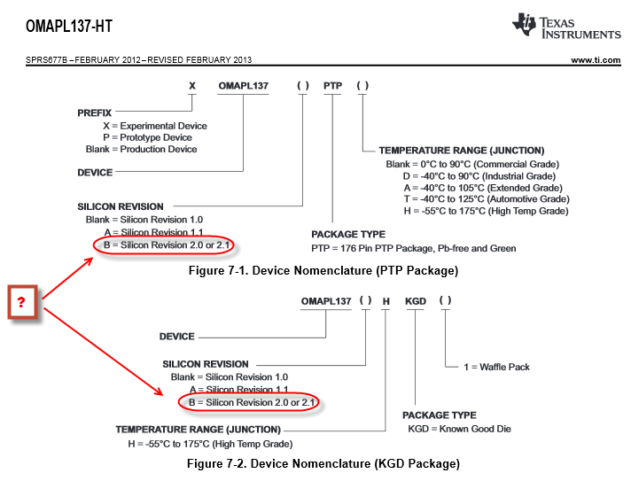

OMAPL137HT Silicon Version 2.0 or 2.1 regarding Errata Advisory 2.0.20 Intermittent Boot Failures ?
Other Parts Discussed in Thread: OMAP-L137
We are working with part # OMAPL137HTBPTPH-YF-1BA1TZW G4, in which the nomenclature on the Datasheet indicates that 'B' indicates silicon version 2.0 or 2.1, can it please be clarified what specific version that is so we can know if the Errata Advisory 2.0.20 is present or not?
This is urgent as we are in the final stages of the bootloader process and we are not sure if we are hitting this bug or not.

  • Update: Can a moderator please move this forum to the OMAPL13x, I don't think I have that capability as a user :).
    Moving this post to the OMAPL Forum as I've verified the si version that I have after running the OMAPL1x_debug.gel file mentioned in one of the boot related wikis, it appears I have Si 2.1, so I should not be facing this bug, however I am still having issues with booting from ARM via SPI1 Flash.

  • updated post with a picture showing the confusion point in the OMAPL137HT datasheet.-M.Alanis

    update: of confusion area that needs clarification on the OMAPL137HT datasheet or instruct a way on how to determine this.

  • Hi Miguel,
    Would you please reload the picture? Might be some problem during attachment.
    Shankari
  • Hi MAlanis,
    Running the OMAPL1x_debug.gel will determine the silicon revision and I believe it as a correct method.
    Shankari
