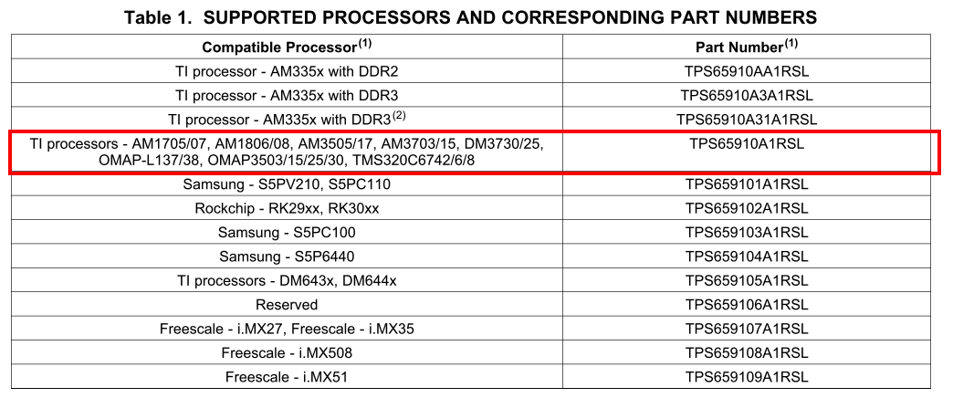

We have a question about PMIC connect to C6748.
We see the TPS65910 can be support TI-TMS320C6742/6/8 process on the website. (See picture - A)
But, this table has suggested the TPS65910A to C6748 in the datasheet of TPS65910. (See picture - B)
Then we see TPS65910A website. It is not suggested use in the C6748 platform. (See picture - C)
Would you help us to suggest a PMIC for C6748 platform.
Thank you~

  • Hi Chien,
    That is missed out due to documentation slips. But if you look at both the datasheets of TPS65910 and TPS65910A C6748 processor is mentioned in the supported processor list.
    Also you can refer powering the C6748 app note http://www.ti.com/lit/an/slva490/slva490.pdf
