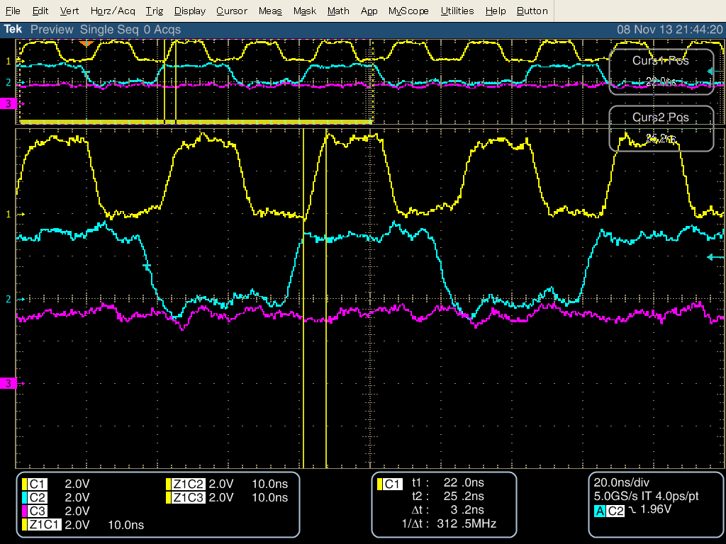

I was measured for each power supply is connected to the DM8168 for evaluation.
A circuit configuration is the same as NETRA EVM (DWG No.512872-0001).
However , the pull-up resistor is using 10kΩ.
I confirmed the timing of the SD for evaluation.
No problem in Normal mode and Identification mode.
There is a problem that does not satisfy the set-up time in the High-speed mode.
Please refer attached waveforms.
CH1(Yellow):MMC_CLK CH2(Blue):MMC_CMD CH3(Purple):MMC_DAT0

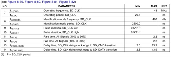

Setup time is about 3.2ns. Therefore , it does not meet the minimum specifications 4.1ns.
Hold time is about 15.0ns. Therefore , it is meet the specification of minimum 1.9ns.
it is meet specifications other than setup time .
Is it permissible that the setup time in High-speed mode is unsatisfying?
Is there any solution for problem in the case?
