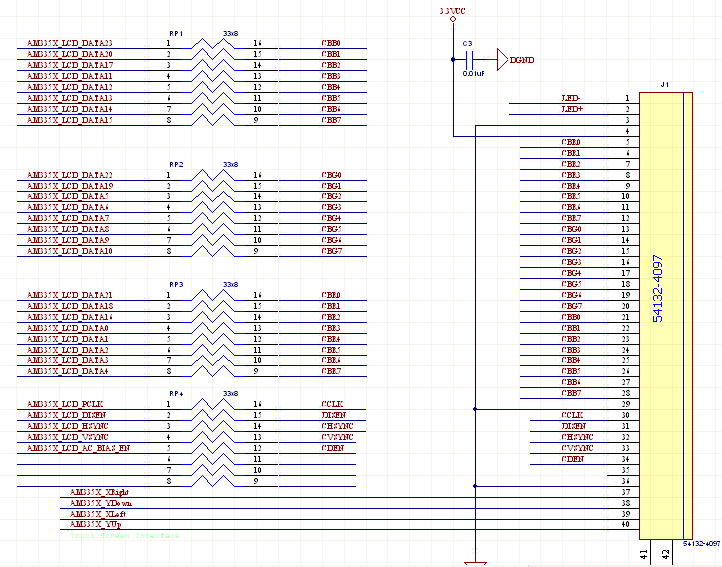

I am using  linux-3.2.0-psp04.06.00.11,the touch screen is HD-4.3-480272EF-ATXL#-T which is resistive touch screen,the schematic is attached as image,please refer to it.
Refered to AM335x Starter Kit,
AM335X_XLeft is connected to AIN0 of AM3352,
AM335X_XRight is connected to AIN1 of AM3352,
AM335X_YUp is connected to AIN2 of AM3352,
AM335X_YDown is connected to AIN3 of AM3352,
The Matrix GUI application could be run correclty and be showed on LCD,
but even if i touched any icon of program(such as Power),there had no response,
so i used Oscilloscope to probe AM335X_XRight,AM335X_YDown,AM335X_XLeft and AM335X_YUp,
these pins all had signal.

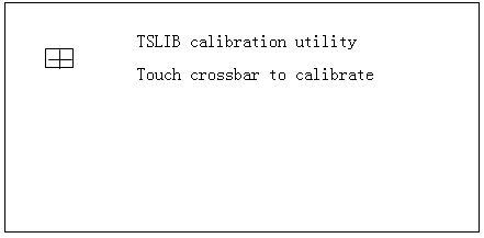

    When you run the calibrate_ts utility, do you see all the 5 crossmarks that appear on the screen?
    How many wires does you touchscreen use? Is the struct tsc_data am335x_touchscreen_data inside the board-am335xevm.c file correct?
    Miroslav
  • Hi Miroslav
    Thanks a lot for your reply.
    I saw only one crossbar on the screen.
    I use 4 wire for touch screen,
    I did not modify the content of  struct tsc_data am335x_touchscreen_data.
    i also did not modify anything for touch screen.
    now i still have no idea to fix the problem.

  • long qin said:
    Calibrating touchscreen (first time only)xres = 480, yres = 272
    Is this screen resolution correct? Are you able to see the whole Matrix App Launcher on your LCD or is the screen cropped?
    You say you saw only one crossmark on the screen. Where was is located and did you touch the screen 5 times at the same place?
    Miroslav
  • Hi Miroslav
    The TFT & TSC is NHD-4.3-480272EF-ATXL#-T which is the same with AM335x Starter Kit,so
    i think the resolution of the TFT is correct.
    i'm able to see the whole Matrix app on my TFT,and the Next symbol  also can be seen.
    "where was the crossbar  located?" -->Please refer to the attched image
    i  exactly  touch many times(I can not be sure only 5 times ) at above place

  • I'm sorry, I didn't understand if the crossbar changes position after you touch it the first time? The sequence should be: Top left, Top right, Bottom left, Bottom right, Center - one touch each.
    Miroslav
  • Hi Miroslav
    After i touched the crossbar,there was no response,and the position did not change,
    so the sequence you described above did not appear.
    Best Regards
    Qin Long
