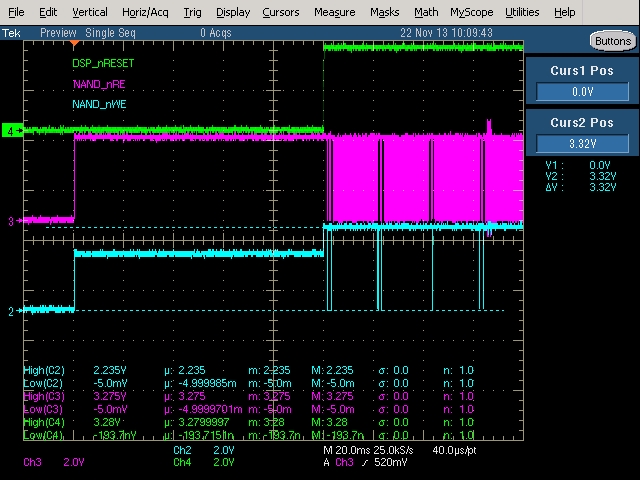

Found the EM_WE (pin J15) & EM_OE(pin J19), both pull-up to 3.3V through 10k resistor, are showing two of the above different behaviours:
EM_WE will stay at around 2V after 3.3V is applied, but the RESET# pin is still asserted (Seems like the pin is pulled down internally with 20k impedance??). The EM_WE will only rise to 3.3V after the RESET# is released.
EM_OE will rise to 3.3V once 3.3V is applied, regardless of whether RESET# pin is released or not.
Please refer to the waveform attached.
Kindly advise if these is the characteristic of DM365/DM368?
