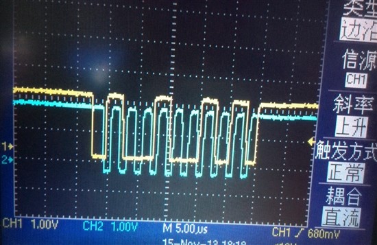

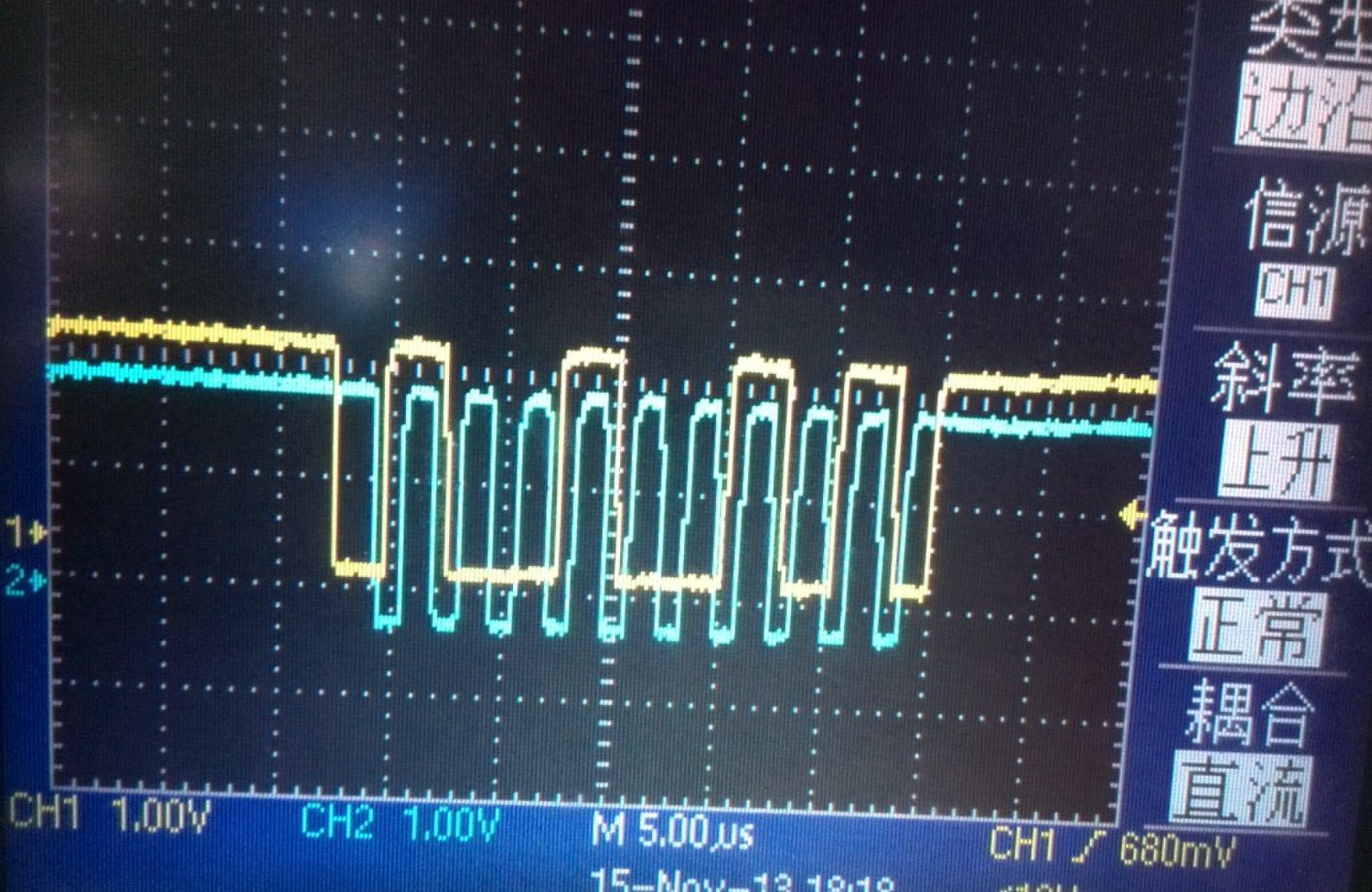

I am using the TPS65910 to manager DM3730's power,but it does not work.
the i2c address of TPS65910 is 0x2D,and I find that DM3730 try to communicate with a address of 0x49.
I think that is the reason.
and someone know h ow to fix it.

    Thanks for your reply.
    This problem is occur,when I want to boot dm3730 from MMC,No external code is involved in this process.
    That is to say OCM_ROM codes set the I2C slave address(I2C_SA).I confirm it by JTAG debugger.
    How to change this I2C_SA in booting?
