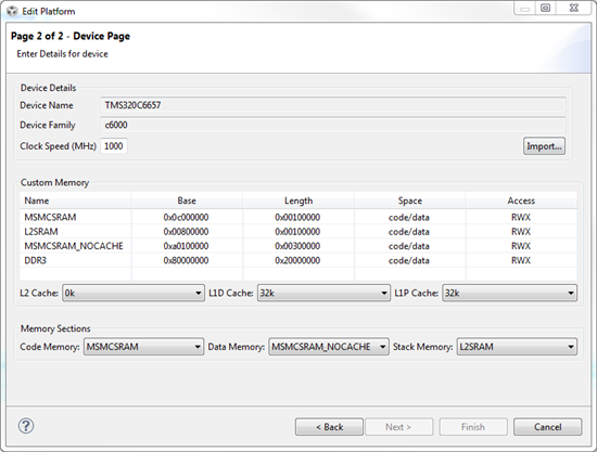

I trried to examine the basic OpenMP example (http://processors.wiki.ti.com/index.php/BIOS_MCSDK_2.0_User_Guide#Multicore_Hello_World_Example) on my C6657 EVM. After setting the number of Processor to 2 and creating a platform with MSMCRAM_NOCACHE section, I get the following error:

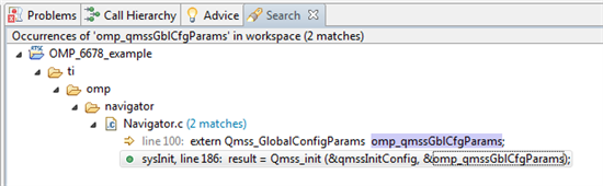

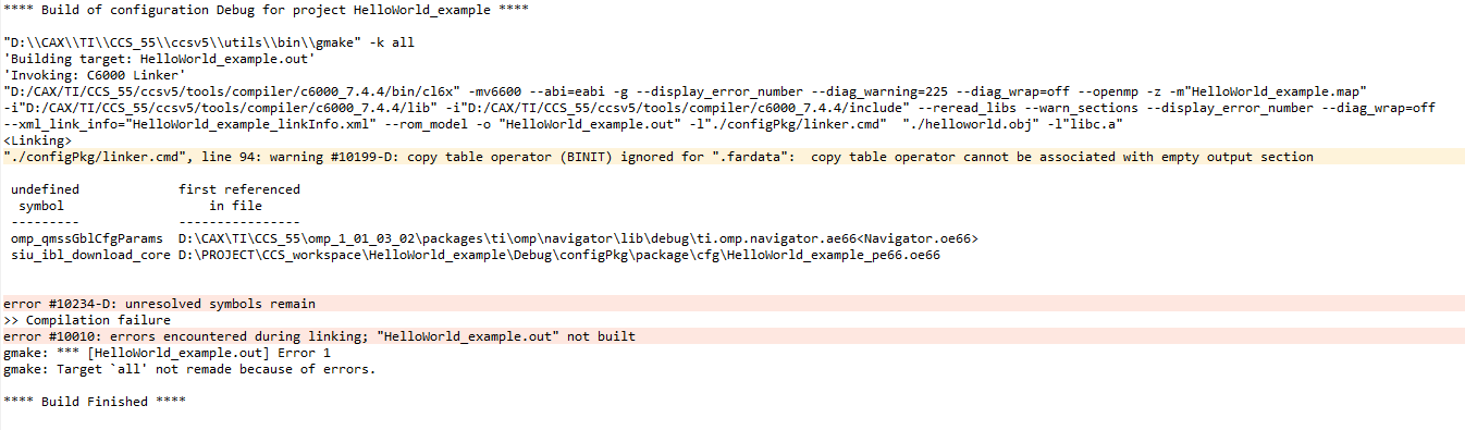

    I got the error above (screen shot): unresolved symbols: #10234-D.
    The unresolved symbol ist "omp_qmssGblCfgParams".
    I found this variable in Navigator.c (see below), but do not know how to interprete this error message.

  • Hi Gregor,
    Based on the screenshot in your most recent post, it seems that the error is unrelated to your changes.  This is a build error, so changing the number of OMP cores shouldn't be causing this.
    I noticed your first post mentions you're using the C6657EVM, and your most recent post indicates you have the C6678 OMP example project.  Which hardware are you using?

    > When I choose the ti.omp.examples.platforms.evm6678 (just for testing), no building errors, but after loading the .out to my platfrom it runs directly and I do not get any output. That's way I assumed the changing to the right platform might be a good idea.

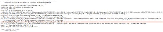

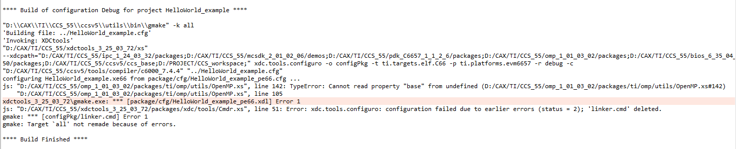

    > When I choose the ti.platforms.evm6657 (there is no omp.examples.platform fpr 6657 as I know), I get the following error:
    > After some search online, I created my own platform, based on the C6657 device:
    > When I try to build this, I get the error described above:
