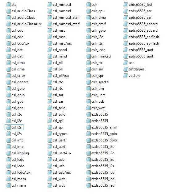

I have the "lnkx.cmd" present in the project directory where this source file is present. I also have " ezdsp5535bsl.lib" present in the same directory. In the "Include Options", I have added the directory where all the following files are present. Below is the snapshot:
By default, there is another include present: C:\Program Files (x86)\Texas Instruments\ccsv4\tools\compiler\c5500\include
Now, when I build this project, it gives the following results:

The Problems Window looks like this:
I have provided all the details. If anybody here could help me to solve this problem, it would be really good.
