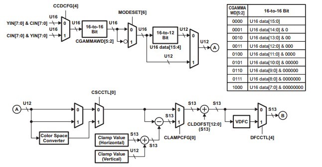

Now I interface the DM8127 ISS with a 14bit CCD AFE chip based on Appro DM8127 IPNC Reference Design. I use the Low power and DDR capture mode,so I can capture the raw data of image into DDR in the camera link. but I find a very strange problem:the sensor is a 14bit raw sensor,and interface with dm8127 using CAM_d13 to CAM_d0,so i think in the captured raw data in DDR memory, the max data should be 0x3FFF, but however I tried, the max data always be 0xFFF, it seems the upper 2 bits has been removed automatically, I don't konw how to solve the problem,any one can help me?

    because i use a 14bit sensor,so I just change the msb bit setting in the isif:
    gIss_captCommonObj.pIssConfig->eMsbPos = MSP_IPIPE_BAYER_MSB_BIT13;
    isif_reg->CGAMMAWD = 0x04;
    the others codr is same to be DM8127 IPNC RDK.
    I don't have the detailed isp document on DM81xx on my hand, so i have to reference the dm36x vpfe document, I find if interface with raw sensor, dm36x isif only can output 12bit data not 16 bit, and in the isif pipeline, there is a 16to12 bit section to convert the input data to be 12bit, so is it the reason of the max value to be 0xFFF from isif?

  • Hi pavel4378,
    Try below setting,
    isif_reg->CGAMMAWD= 0x04 indicates 12-bit data !! it should be 0x02 for 14 bit data.
    If you set it as 0x04 2 bit will be simply flushed out, which is not correct.
    also check CCDW value of isif modeset register

    I find the following material from dm36x vpfe manual:
    P61 figure 4-4:
    from the figure,we can see a 16bit-12bit conversion block
    P85 4.3.4 Input Interface:The IPIPE engine receives 12-bit RAW image data or 16-bit YCbCr data via IPIPEIF.
    From the upper material,I think there is a limitation of input bits on isif raw data, when we use dm36x to interface with 14bit or 16bit raw sensor, the isif will write raw data into ddr with 12bit data. But I don't confirm that is is suit to DM81xx?Could anyone who have DM81xx ISP user manual in hand can help me to see the isif raw data path, and confirm that is it suit to dm81xx?

  • OK,
    Now your problem is clear to me. To answer your question,  isif raw data path in DM36x and Dm814x are same. Yes it is having same 12-bit raw limitations. But, since you are trying to capture 14-bit RAW, expected was you are not configuring as RAW mode.
    Now I have a question to you. Since you are trying to dump 14-bit data, why u cant fake it by saying it as YUV instead of RAW?. So that you can get all 14 bits in 16 bit pack!!
