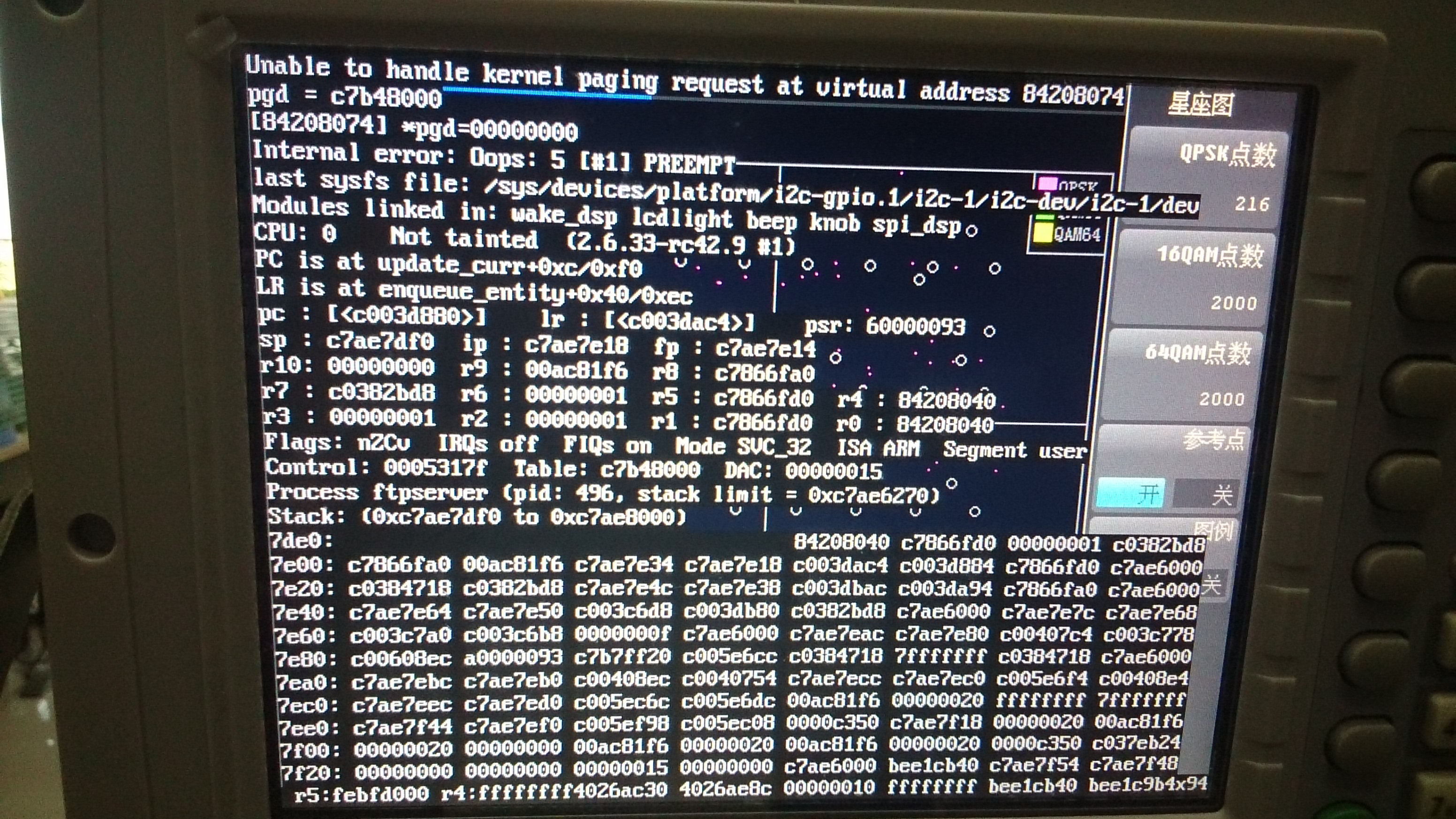

    There is an error when my board is running in 372MHz,but my omapl138 support 456Mhz.
when the error occurs ,the print  like this.what is wrong with my system?
thanks
  • Hi le lemon,
    Would you please, send us the log of your boot parameters, boot commands used and the output messages while booting the kernel in the form of a text file, so that we can have a closer look to your problem?
    Shankari
  • Hi , Shankari
        Thanks for your reply.
     boot parameters and boot commands:
    bootdelay=1
    baudrate=115200
    bootfile="uImage"
    ethaddr=00:32:32:32:32:32
    bootargs=mem=128m console=tty0 root=/dev/mtdblock0 ro rootfstype=yaffs2 quiet
    stdin=serial stdout=serial stderr=serial
    ver=U-Boot 2009.11 (Jul 07 2011 - 16:50:38) filesize=4B29E fileaddr=C0700000
    ipaddr=192.168.0.138 serverip=192.168.0.145
    bootcmd=sf probe 0 30000000; sf read 0xc1700000 0x380000 0x80000; sf read 0xc0700000 0x80000 0x200000; bootm
    output messages :in text file

  • HI le Lemon,
    From the log file, it seems to me that your kernel is trying to mount the YAFFS/YAFFS2 file system from NAND Flash.
    Using a wrong YAFFS image may also lead to errors like this. For more information please refer to http://processors.wiki.ti.com/index.php/Put_YAFFS_Image_to_Flash
    Before booting kernel, are you able to successfully flash the rootfilesystem (YAFFS2 ) into NAND? Did you use  MTD Utilities for flashing?
     If you are not very particular about using filesystem at NAND flash, you can opt using nfs filesystem which is comparitively easy.
    http://processors.wiki.ti.com/index.php/Alternate_Boot_Methods_for_OMAP-L137/DA830#From_NFS
    http://processors.wiki.ti.com/index.php/Booting_Linux_kernel_using_U-Boot
    http://processors.wiki.ti.com/index.php/Getting_Started_Guide_for_OMAP-L1
    Shankari.

  • Hi ,Shankari:
        We deed use the YAFFS/YAFFS2 file system on NAND Flash. The system mount file system only once when
    the system start up ,we didnot access the nand flash before the system breakdown.Is there another  problem ?
  • Hi le lemon,
    Please answer our question on our previous post to help you further.
    Are you able to partition the NAND successfully?
    It seems to me that the system is not able to mount the YAFFS filesystem properly from NAND.
    Shankari

    Yes,I did .
    2)are you able to successfully flash the rootfilesystem (YAFFS2 ) into NAND?
    Yes Idid
    3) Did you use  MTD Utilities for flashing?
    No ,I didn't.
