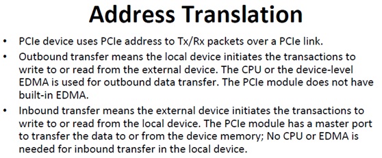

Recently ,I need to use PCIE in my daily work.And I had saw some reference material.But
I cannot understand the meaning of inbound and outbound all the time.
In my opinion, For the same PCIE visit or access,you can say inbound and you also say outbound
too.
For example,Now I suppose RC(played by PC linux host)  access EP (played by DSP c6678) via PCIE.
According to one of the reference material I found in google below:
I think I can say this access belongs to inbound and I also can say this access belongs to outbound.
it's all decided from which side.
1.From PC host RC side
According to the above reference material ,PC host RC can be considered as the local device.
and DSP c6678 EP can be considered as the external device.So the access initiates by local device
_PC host linux RC. Of courese this situation belongs to outbound .

    Inbound address translation is used to remap accepted incoming accesses from other
    PCIe devices to locations within the device's memory map.
    Outbound Address Translation maps internal bus address to PCIe address space. This is accomplished by using outbound address translation logic. For each outbound read/write request, the address translation module within the PCIESS can convert an internal bus address to a PCIe address of memory read/write type.
    See also the PCIe Users Guide:
    http://www.ti.com/litv/pdf/sprugs6d
    Kind regards,
    one and zero
  • To avoid those confusions of inbound/outbound terms, it good to understand the how PCIE read/write works and how address is translated. You can read the same document sprabk8 examples 1,2,3,4.
    Regards, Eric
