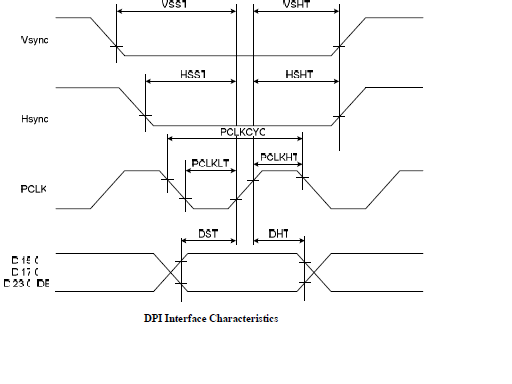

    Hi Steve,
    Thanks for the support.
    There was one timing chart for DPI inteface(HX8358) as shown below,
    I think this is OK against OMAP-138 LCD timing chart.
    Regards.
    Prad
