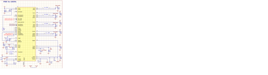

    2. in my current design , I have left pin PWRON (external on/off control) open as well, is it ok? I have attach the schematic for PMIC circuit, can you help double check what should be improved for better design and EMC as well?

    2. Seems OK to me. I suppose you have pullups on I2C0 somewhere else on the schematic.

    I have pull-up for I2C0.
