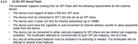

Can C551x support the Serial NOR boot?
According to the Bootloader user's guide(SPRABD7), if can meet some requirements, C551x can support SPI Flash boot.
Just in case, I inserted the captured picture which is wrote about SPI flash requirements as below.
If you have any qeustions, please let me know.
