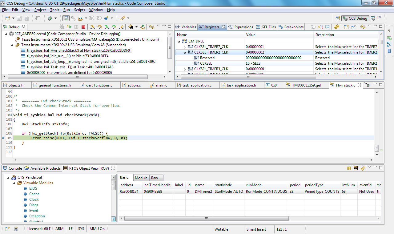

  • Hi Ashish,
    I checked for Timer2 value (which I suppose is used for DMTimer in ICE). The register window shows the value as 0x02 and not 0x01(defalut). I am attaching snap shot for CCS.
    Please let me know how to change this to 24MHz or I can configure the timer in *.cfg file to 32K?
    Thanks & Regards
    -Balwant
  • Hi Balwant,
    The dmtimer module has the timer frequencies set as 32KHz by default and that is the reason you were getting the frequency mismatch error. The dmtimer module timer frequencies did not match the actual timer frequency which is ~26MHz according to the timer module frequency check logic.
    Can you confirm which timer Ids are being used from the ROV->Timer view when you get the frequency mismatch error ? I wonder if different timers are configured to use different clocks. That would explain the problem.
    Please share the basic, device and module view of the timer.
    Ashish

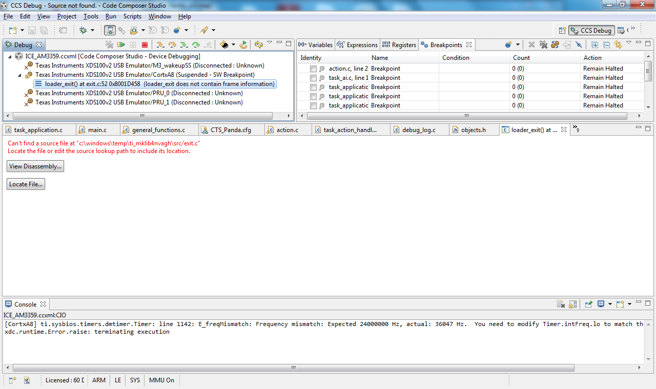

  • Hello Alan, Ashish,
    I enetered the code you suggested in the *.cfg file
    var Timer = xdc.useModule('ti.sysbios.timers.dmtimer.Timer');
    Timer.intFreq.lo = 24000000;
    Timer.intFreq.hi = 0;
    Now I get the following error every time I try to connect the debugger
    [CortxA8] ti.sysbios.timers.dmtimer.Timer: line 1142: E_freqMismatch: Frequency mismatch: Expected 24000000 Hz, actual: 36047 Hz. You need to modify Timer.intFreq.lo to match the actual frequency.
    xdc.runtime.Error.raise: terminating execution"
    Am i doing somthing wrong in the cfg file? Please let me know how I can made SYS/BIOS to understand the required frequency.
    Please find attached snap shot for error.
