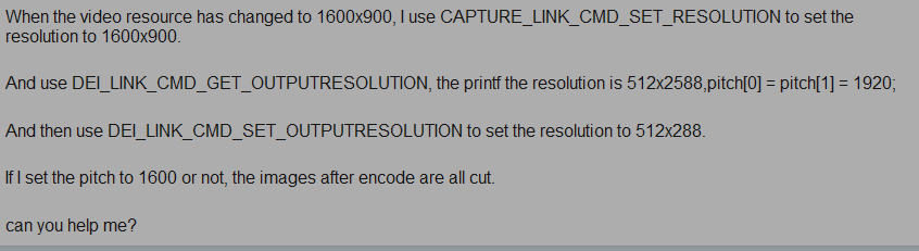

  • I create 2 channel. The dataflow is
    I set the dei resolution with rate 1:1, and call DEI_LINK_CMD_SET_OUTPUTRESOLUTION to set the smaller resolution, this is OK.
    But if I another change the capture input resolution with CAPTURE_LINK_CMD_SET_RESOLUTION, the resolution after dei is cut.

  • Are you actually changing camera source to output smaller resolution or are you just invoking  CAPTURE_LINK_CMD_SET_RESOLUTION ? It looks like you are invoking CAPTURE_LINK_CMD_SET_RESOLUTION without changing the camera source resolution.CAPTURE_LINK_CMD_SET_RESOLUTION doesn't do anything to changes the frame resolution. It only informs the next link about the resolution.
  • Hi, Badri.
    I'm sure I change the video source, because I write the channel 0(capture->dup->encode) to file, the file resolution has changed.
    After I change the source resolution, I call the CAPTURE_LINK_CMD_SET_RESOLUTION .
    The channel 0 is normal.
    But the channel 1(capture->dup->dei->encode) is not normal.

    If I detect the input resolution has changed, I will call setInputResolution().
    Can you give some advie?
    Thanks very much.

  • DEI does not detect & use output resolution based on incoming frames resolution (dynamic change).
    Use DEI_LINK_CMD_SET_OUTPUTRESOLUTION command after a change in capture resolution.
  • Make sure you do DEI_LINK_CMD_GET_OUTPUTRESOLUTION change the width and height and then do DEI_LINK_CMD_SET_OUTPUTRESOLUTION else pitch may get wrongly set
  • Pitch should be 1920 .You should not change it.Pls enable

  • I define SYSTEM_DEBUG_DEI_RT, and after I change the capture input resolution, the console only print:
    [m3vpss ] [links_m3vpss/capture/captureLink_drv.c:334] 188204: CAPTURE: Dynamic resolution change: width: 1600, height: 900,startx:0,starty:0,pitch0:1920,pitch1:1920!
  • You have to rebuild using make dvr_rdk and use the rebuilt image.Share the full console logs after rebuild and switch resolution

  • The logs show  both capture and DEI correctly detecting the resolution change.
    [m3vpss ] [links_m3vpss/capture/captureLink_drv.c:334] 149411: CAPTURE: Dynamic resolution change: width: 1600, height: 900,startx:0,starty:0,pitch0:1920,pitch1:1920!
     [m3vpss ]  149425: DEI: CH0: Input Picture Size is changed to width = 1600, height = 900!!
    Have you done any change in DEI link like disabling scaler or enabling lazyLoading ?
  • I enable lazyLoading. If I disable, it's OK now.
    Thanks very much.
