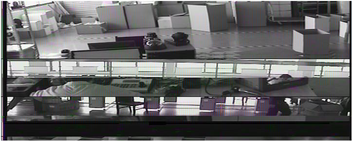

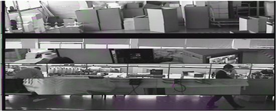

  • thank u for your reply.
    Yes, i get video data from the VPFE, but the video is not right:
    1. I config the VPFE to get two PAL vdieo, that means a super-frame of 576*2. In the super-frame, there is no any data in odd line, in even line, video data is gathered from 2ch video.
    2.The video data in even line is composed of two 576/2 video, i split  the 576 lines video data to two image according to interlaced order . please refer to the attached 2 pics.
    I think befor the proper configuration of vpfe of 6437 will de-multiplexed 2Ch video automatically by hardware. now i know i must write code and consume cpu load to  de-multiplexed 2Ch video manually by identify the start code after SAV/EAV.
    i am working hard for this.

    This is probably a good way to start since it is easiest to debug de-multiplexing issues when working within the software, in the long run you probably want to use the DMA to de-multiplex the streams so it is more efficient, as this would take less CPU overhead.
    As to your video streams, it looks like there are synchronization problems with an offset vertically so it may be worth verifying the VPFE settings, though this could also be an artifact of problems with the de-multiplexing

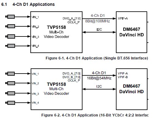

  • Hi Bernie,
    Thanks for your reply. One more question needs your help.
    If 4-ch video are all D1 resolution, does 6437 can connect with TVP5158 using 4-Ch D1 (16Bit@54MHz) configuration.
    does video capture performance still can achieve 30fps?
    It looks like this configuration is not possible, the DM6437 only supports embedded syncs in bt.656 mode which only supports an 8 or 10 bit wide bus, and the TVP5158 only supports embedded syncs, no external syncs.
    If it was possible you would still be able to achieve 30fps of capture, however that would be a lot of data for a single DM6437 to process if you intended to do some sort of video compression or advanced video processing, so you may find yourself performance limited with 4 channels of D1.
  • Hi Bernie,
    Thanks for your kindly reply.
    Currently, our critical path is using EDMA to capture 4-ch D1 video at 30fps to DDR RAM.
    So I got the conclusion is "DM6437 can not act as DM6467 to connect TVP5158 under either one of below 4-ch D1 applications"  .
    Is it right?
    Is it right?
    This is true. For the first implementation of 8bit at 108MHz this is not possible as the DM6437 has a maximum pixel clock of around 98MHz, 108MHz would be out of spec. For the second implementation this is not possible because of the reasons mentioned in my prior post, namely TVP5158 not providing external syncs and DM6437 being unable to capture 16 bit wide data without external syncs.
    The DM6467 uses a different video port mechanism known as VPIF, which is a simpler interface in many ways but that happens to support bt.1120 with embedded syncs for 16bit wide data.
