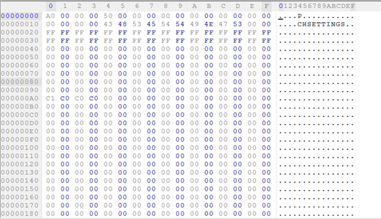

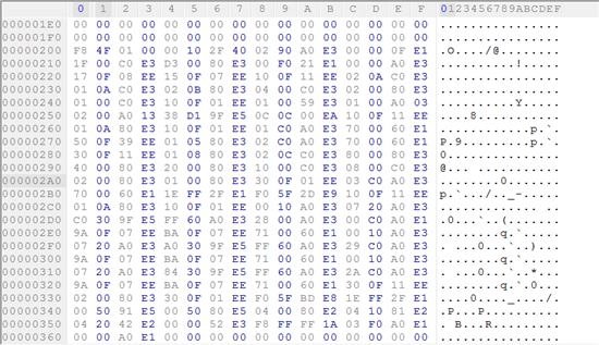

I have created the xldremmc.img file for the AM335x processor. But, I'm not able to boot from the eMMC. I have flashed the image to the eMMC. I confirmed it by reading the first few sectors of the eMMC from the eboot. Sector 0 contains the header information and from Sector 8 the x-loader contents are available.  I just get the continuous 'CCCC's meaning that it is searching for a boot source from UART. I have checked the boot settings and got confirmed that boot settings are set as eMMC only. The below image contains the dump of first few sectors, starting from 0. It contains the header information. My doubt is, whether the header information, as mentioned in the image, is suitable for booting from eMMC. Does AM335x processor expect anything else than this?
Kindly guide me. Thanks.
