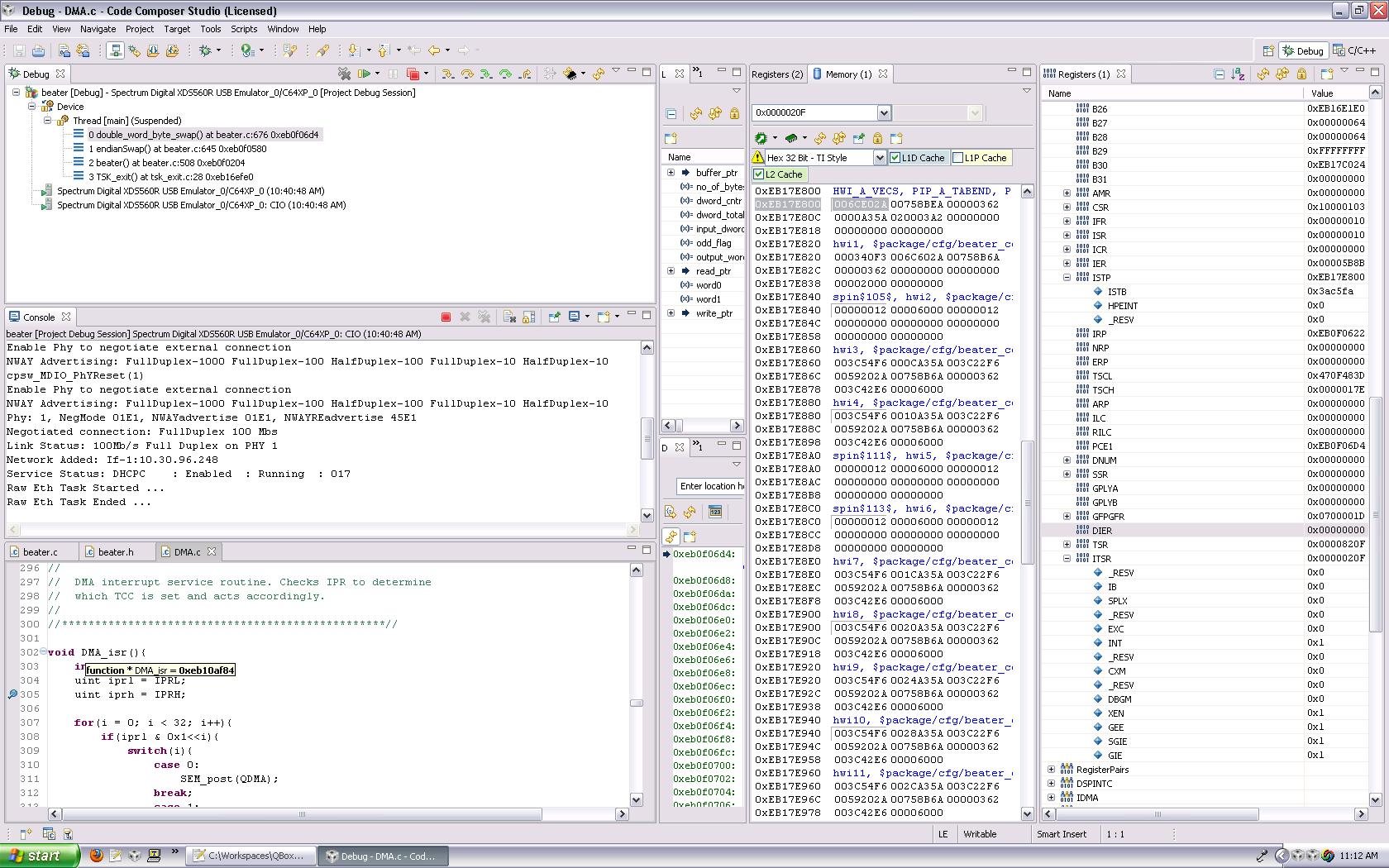

  • Here is a screen shot showing my interrupt vector table. I am using HWI4 but it doesn't seem to contain the address of DMA_isr()
  • The EDMA User Guide has a footnote saying to make 32-bit accesses to the Parameter RAM whenever possible.  I believe the way you've broken up the accesses (e.g. ACNT and BCNT as separate accesses) as well as the bit-fields for OPT are potentially causing problems.  This might be tied into the odd issues you're seeing with interrupts.
    Since you're using the BIOS dispatcher, the interrupt vector table will branch to the dispatcher, not to your ISR.  That's fine.  At the end of your ISR you should write IEVAL=1.  That's obviously not causing this issue, but could cause you to miss an interrupt at run-time (once you get the interrupts working!).

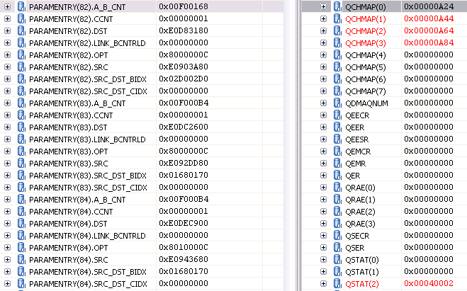

    A channel's QEER is always disabled until inside my start function when it gets set right before i rewrite my trigger word and then it is immediately disabled again.
    Here is a screenshot of my PaRAMs and QCHMAPn. I am using channels 1-3 with PaRAMs 82-84

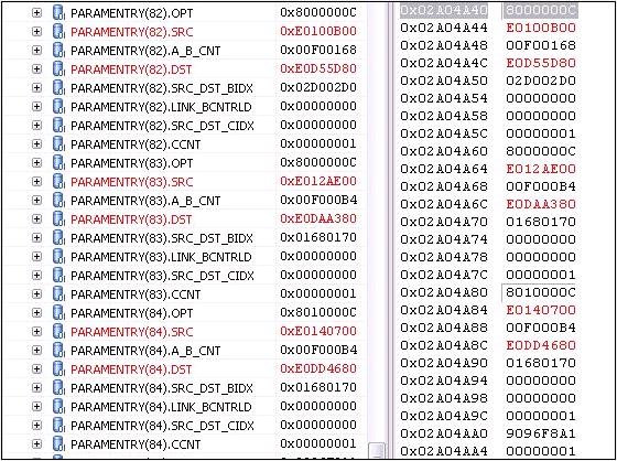

  • Will you please open a memory window to address 0x02A0_4A40 and take a screenshot similar to the one above?  I'd like to be able to rule out errors that could arise from defining the parameter sets incorrectly in your code.
  • In order for TCC to cause a bit to be set in IPR/IPRH you need to set the TCINTEN bit.  For parameter sets 82 and 83 you will never know when they complete as it is currently programmed.  For parameter set 84 it will set bit 0 of IPR when it is complete since TCC=0.
    As long as TCINTEN is set, then you should be able to program OPT.TCC to any value and see the corresponding bit in IPR/IPRH set upon completion of the transfer.
    I thought that since they are all loaded into the same FIFO queue that 83 would not start until 82 was finished and 84 would not start until 83 was finished. Thus only requiring an interrupt on the completion of 84, since i need them all to complete before I do anything else.

  • Here is the screenshot of the memory locations
  • Let me make sure I understand where you're at right now.  So at one point you could not generate a CPU interrupt, but I believe that was due to the fact that CPU.IER was not configured properly, right?
    For the purpose of debug, please try the following:
    1. Comment out the line of code that sets the appropriate bit in EDMA.IER.
    2. Run your code "as is" such that TCC=0.  You should see IPRL.BIT0 set at the completion.
    3. Re-run the test this time with TCC=1.  You should now see IPRL.BIT1 set at the completion.
    If item 3 doesn't work please check to see what has been transferred to determine if the QDMA transfer was successful, i.e. was the destination updated in its entirety.

    Now I just need to work out why my interrupt isn't firing... I can't remember if I had to set something special for each TCC...
  • Great news!  Are you positive that you NEVER get the interrupt?  Whether you're using TCC=0 or TCC=1, etc the interrupt functions exactly the same, i.e. it's a shared interrupt.
    Since you were already getting the interrupt I don't see how the fixes you made would "break" the interrupt.  A couple things to check in your ISR:
    • You need to clear the IPR bit as you service it.
    • Write IEVAL=1 before exiting the ISR.
    The above steps would fix the case where you get it once only.  Perhaps that's what you mean (or maybe you set the breakpoint after it had already run).
    Brad
  • Ok, thanks. I am pretty sure I am not getting the interrupt. I thought they were on the same interrupt and that's why I confused when it didn't fire. I will confirm whether or not its firing and try your suggestions on Monday. We are getting out early today do to the inclement weather in Atlanta.
  • The interrupts were firing... At the beginning of my ISR I stored IPR into ipr but I masked it with ipr & 0x1 for when I was just trying to interrupts working. So now I have interrupts firing on all TCCs. Thanks alot!
    What does IEVAL = 1 do?
