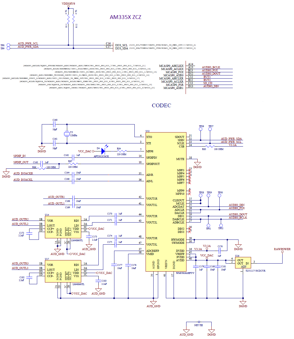

I'll walk through what i have thus far.  Here is my hardware setup:
As far as software goes i basically modified the board file to setup the pins for using MCASP0 and I2C0 for communication with the Codec:

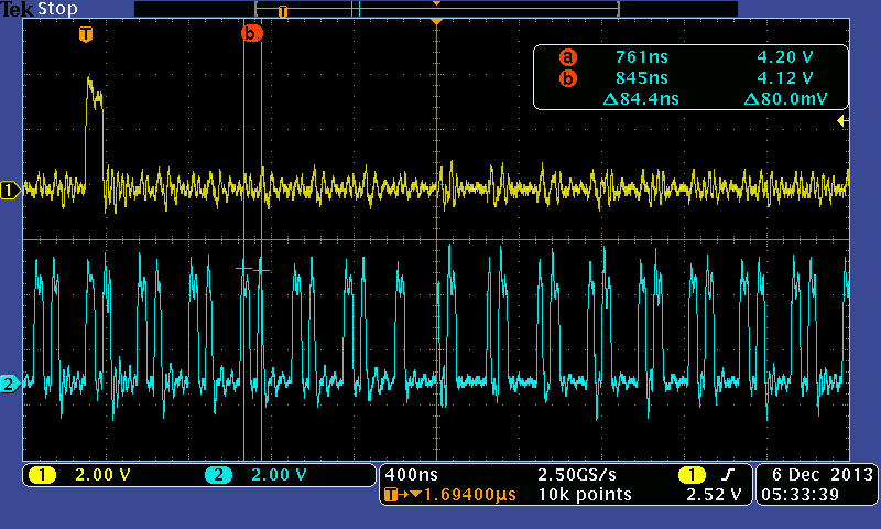

  • Hello Jarrod,
    Is your codec meant to be the I2S master?  If so, have you verified that is generating the proper bit clock and frame sync and that those signals are reaching the McASP pins?  Additionally, have you checked to see if your frame sync has the form of the format that you intend to use(DSP mode versus I2S mode, for example)?
    If your clocks are being generated correctly, have you scoped the serial data lines to see if there is activity?
    While you are playing your wav file, can you do a cat /proc/asound/card0/pcm0p/sub0/status a couple of times to see if you see the pointer values changing?  I suppose this would be a test that tells us that same thing as checking the actual I2S lines, but it's worth trying out.
    Josh
  • Thanks for the suggestions!
    Yes the Codec is meant to be the master.
    I had scoped the clock and sync lines earlier on when i was still working through getting the code setup and they were fine then.  However, i guess i did not recheck them after i finished code modifications because in scoping them now i found an interesting thing.  The clock looked like this (yellow is frame sync and the blue is the bit clock):
    Which says to me there is clock collision.  I dug into the issue more and found that the clkout on the codec was enabled and i was running the codec's mclk from its PLLA.  And since the clkout and mclk pins are shorted together this caused the crazy clock above.  Originally we had planned to have multiple codes and the clkout was just sourcing the mclk of all codecs, but that changed.  Anyways i see possible solutions as:
    1. Remove the short between clkout and mclk
    2. Set the clkout pin output to NONE (tri-state)
    3. Source mclk from the pin
    For now i chose to go with option 2 and simply added this line to my evm_hw_params function in sound/soc/davinci/davinci-evm.c:
    	/* Make nothing drive the clkout pin */
    	ret = snd_soc_dai_set_clkdiv(codec_dai, WM8580_CLKOUTSRC, WM8580_CLKSRC_NONE);
    	if (ret < 0)
    		return ret;
    Now my clock looks good:
    And my sound files are playing as desired : ).  Now just to work through getting all the ALSA channel mapping stuff setup.  Thanks for your help!!! : )

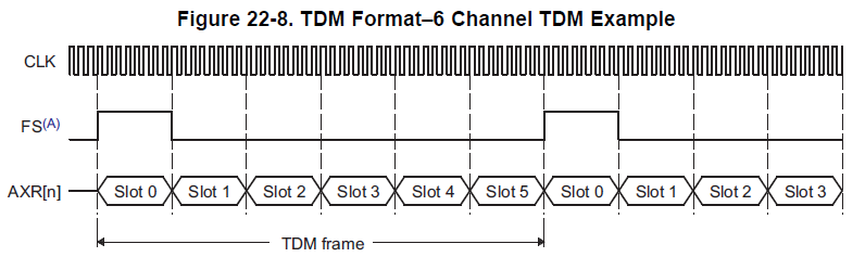

    One thing to point out is that by looking at your framesync, it looks like you are configuring your codec to use something like DSP mode, whereas the default state of the mcasp driver is to be in I2S mode.  Have you resolved this possible issue?
    Josh
  • Josh,
    Yes I have the codec in DSP_B mode.  And according to TRM it looks like the MCASP modes are either TDM or DIT and I2S is basically a 2 slot TDM mode.  Judging by the timing diagrams it looks like DSP B would comply with this TDM scheme.  The frame sync low-to-high transition would indicate the start of a new frame at which point N slots would follow.  So even though the DSP frame sync length is only 1 bit clock, it shouldn't matter because slot still starts at the same point at the transition correct?
    AM335X MCASP Timing:
    My sound is playing great right now as a simple 2 slot setup.  When i increase the slots to support the other channels i would imagine it should continue to work as the frame syncs will occur as they do currently and more slots will be just be transmitted between.  I guess i will find out for sure as i add in the other slots : )
