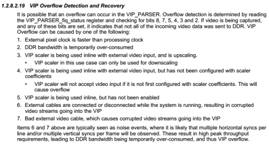

    In DM8148 datasheet, we learn that there are 7 possible factors could lead to VIP0 overflow:
    For 1 and 2, our FPGA team and S/W team tried stress test on DDR bandwidth, but the Corsica memory design is cable of handling the situation.
    For 3, 4 and 5, we don’t use scaler function in Corsica, so they should not be related.
    For 6 and 7, we think that SDI signal is stable enough in Corsica MP product (since there is no CRC error found in FPGA), but we could still see VIP0 overflow.
    Considering the input signals to DSP, we also created NG frame data from FPGA (modify the SAV/EAV of a frame, so the frame data is not complete) on purpose, but that didn’t cause VIP0 overflow.
    Could you help to check if there is any other factor that could lead the VIP0 overflow symptom?

  • First of all, do you know whether this is  a persistent overflow (i.e., a lock up – data not getting written to the memory) or a momentary overflow (data getting captured ok but with wrong frame size information)?
    I see that SDI input type is mentioned.   What is the external device that converts SDI to VIP input data?
    Also, to what format is the data getting captured into memory (422 – i.e., no processing through the VIP)?
    If scaler and other conversion modules in the VIP are not enabled, it sounds more like an intermittent DDR overloading case.
    Would you be able to check the descriptor output to check if a wrong sized frame gets captured when an interrupt is generated?

  • As mentioned by Brijesh initially high b/w DDR access from A8 will cause VIP overflow. The case you have recreated and the actual reason for VIP overflow when running your application may be unrelated to issue you have recreated here.
    1. Have you set the EMIF PBBPR setting as I mentioned previously for this test. If not pls set it and retry.
    2. Pls share the logs of ./sys_pri.out --printAll

  • There are 2 separate issues:
    1. Occasional VIP overflow due to unknown reason.
    2. VIP overflow when running DDR intensive task on A8 like iperf.
    The second issue occurrence is reduced by setting EMIF PBBR as you mentioned indicating it is indeed due to DDR b/w.
    The second issue is also less likely to occur on PG3.0 silicon revision due to better balancing  of DMM requests between A8 and other initiator.
    For the next run setting EMIF PBBPR to 0x10 instead of 0x20 and also comment out below line in init.sh
    ./bin/sys_pri.out --dmm-pri-set HDVICP0 2
    There is nothing to indicate issue#1 and issue #2 are the same issue.For issue #1 Brijesh had provided suggestion for further debug .i.e Try disabling the VBI data channel , monitor for clock skew on VIP input.

  • Hi Chen,
    Is there any chance of DDR reaching 100% bandwidth momentarily? Could you please check it?
    There is a possibility of VIP overflow in case there is no bandwidth to write to memory
    Brijesh

    I have no idea whre you found the section 1.2.8.19 VIP overflow detection and recovery.
    I cannot find it int he newest verison of datasheet. coule you please send me a copy of your document with that? thanks!
    cuiyuelei@outlook.com
    This section is available in the DM814x HDVPSS document, which is under NDA and available through local TI FAE.
