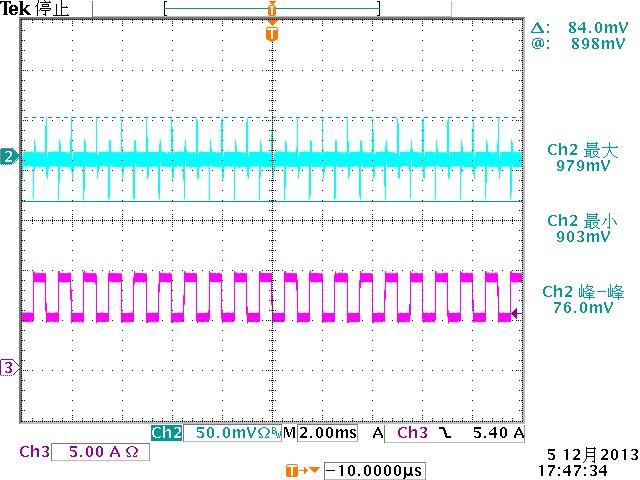

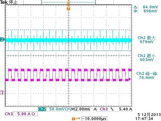

  • hello super badri,
    Thanks. By using your suggestion, we didn't see the messages till now.
    one more thing is I got following messages as listed in http://e2e.ti.com/support/dsp/davinci_digital_media_processors/f/717/t/282354.aspx
    [m3video] 19811902: Assertion @ Line: 449 in links_m3video/codec_utils/src/iresman_hdvicp2_fwif.c: Semaphore_pend(_HDVICP2_context[iresHandle->id].semHandle, 5000) == TRUE : failed !!!
    20167199:!!!SLAVE CORE [VIDEO-M3] DOWN!!!
    SystemLink_copySlaveCoreExceptionContext:152
    mmap of [0xde9c0000:36864]
    mmap virt addresss:0x2aabd000
    munmap of [0x2aabd000:36864]
    SystemLink_copySlaveCoreExceptionContext:159
    SystemLink_handleSlaveCoreException:179
    20167229:!!!SLAVE CORE DOWN!!!.EXCEPTION INFO DUMP
    !!HW EXCEPTION ACTIVE (0/1): [0]
    !!EXCEPTION CORE NAME : [VIDEO-M3]
    !!EXCEPTION TASK NAME : [DEC_PROCESS_TSK_0 ]
    !!EXCEPTION LOCATION : [links_m3video/codec_utils/src/iresman_hdvicp2_fwif.c:449]
    !!EXCEPTION INFO : [Semaphore_pend(_HDVICP2_context[iresHandle->id].semHandle, 1000) == TRUE]
    !!EXCEPTION CCS CRASH DUMP FORMAT FILE STORED @ ./CCS_CRASH_DUMP_VIDEO-M3.txt
    SystemLink_handleSlaveCoreException:184
    by your conclusion as below
         If you get assert fail it confirms HDVICP is hung.
         If hang is inside HDVICP,  hang indicates there is some h/w issue on your board related to AVS power.
    I check with our HW engineer and we have sent our customized board for TI's verification and got the reply saying our AVS ripple is large. I have one question about the range.
    Because our HW engineers always challenge this may be SW issue.
    Could you give me a range of the ripple?
    Thank you very much. Super-man.
