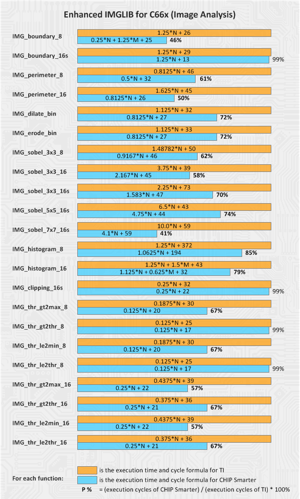

But I found that most of the functions in IMGLIB could be further improved, so I decide to rewrite these image process kernels. I have developed the image analysis section (22 kernels) of the IMGLIB in the past 5 weeks, and almost every function had been improved. It's so exciting for me, and the following is the performance contrast figure:
