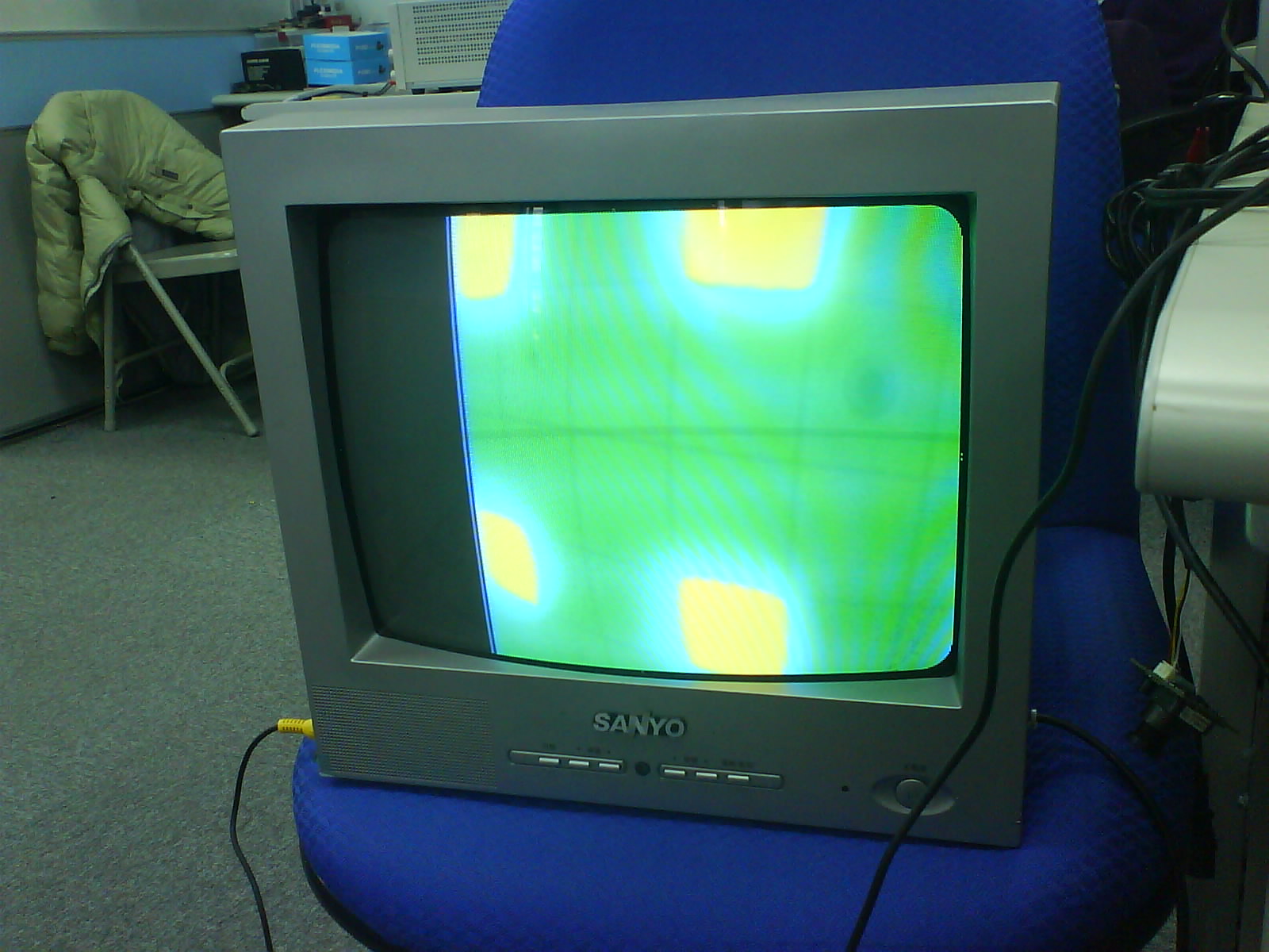

We have customized board, base on DM385, M3 is running IPNC MCFW 3.5 firmware
image sensor is sony imx104, I am modifing the demo multich_capturedisplay.c in
RDK3.5\Source\ipnc_rdk\ipnc_mcfw\mcfw\src_linux\mcfw_api\usecases.

but tv out link below:

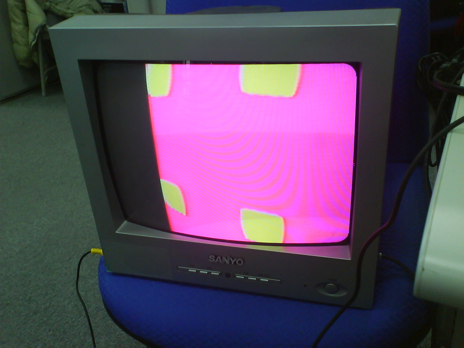

I try change color pattern of ISS register (IPIPE_SRC_COL 0x5C01 080C)
| EE = R    | EO =  Gr |
| OE = Gb  | OO =  B  |
my question is :
1. the color is wrong
2. Missing part of the display positions
how can I do ? or have any idea ?
thank you very much.
  • Hi vic Lin,
    1. You need to correct your ISIF CCOLP along with ipipe CCOLP.
    2. If I remember correctly, CCOLP values for IMX104 is 0xE4. Any ways, please have a look at color pattern support of IMX104 and derive correct value.
  • Hi Ravikiran hv
    Thank you very much for your reply.
    I modify the ISS Source file, it's normal work!
    ti_tools/iss_03_50_00_00/packages/ti/psp/iss/drivers/capture/src/issdrv_captureApi.c
    gIss_captCommonObj.pIssConfig->eColorPattern = MSP_IPIPE_BAYER_PATTERN_RGGB;
    ti_tools/iss_03_50_00_00/packages/ti/psp/iss/core/src/iss_drv_isif.c
    cfg->src_cfg->vd_pol = ISIF_NEGATIVE_POLARITY;
    cfg->src_cfg->hd_pol = ISIF_POSITIVE_POLARITY;
