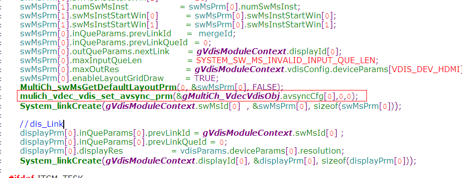

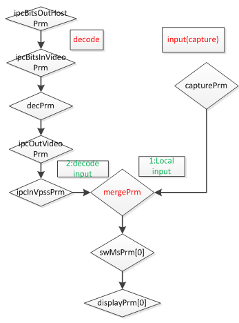

    the following is about my links :
    //Cap_Link
        CaptureLink_CreateParams_Init(&capturePrm);
        capturePrm.numVipInst                      = 1;
        capturePrm.outQueParams[0].nextLink = mergeId;
        capturePrm.isPalMode                             = FALSE;
        capturePrm.tilerEnable                       = FALSE;
        capturePrm.fakeHdMode                     = TRUE;
        capturePrm.enableSdCrop                   = FALSE;
        capturePrm.doCropInCapture               = FALSE;
        capturePrm.maxBlindAreasPerCh          = 4;
        gVcapModuleContext.vcapConfig.enableConfigExtVideoDecoder = FALSE;
            // setting VIP0
            pCaptureInstPrm                            = &capturePrm.vipInst[0];
            pCaptureInstPrm->vipInstId            = SYSTEM_CAPTURE_INST_VIP0_PORTA;
            pCaptureInstPrm->inDataFormat      = SYSTEM_DF_YUV422P;
            pCaptureInstPrm->standard            = SYSTEM_STD_1080P_60;
            pCaptureInstPrm->numOutput         = 1;
            pCaptureOutPrm                            = &pCaptureInstPrm->outParams[0];
            pCaptureOutPrm->dataFormat         = SYSTEM_DF_YUV422I_YUYV;
            pCaptureOutPrm->scEnable             = FALSE;
            pCaptureOutPrm->scOutWidth         = 0;
            pCaptureOutPrm->scOutHeight        = 0;
            pCaptureOutPrm->outQueId            = 0;
             System_linkCreate(gVcapModuleContext.captureId, &capturePrm, sizeof(capturePrm));
             //ipcBitsOutHLOS_link
        ipcBitsOutHostPrm.baseCreateParams.outQueParams[0].nextLink = gVdecModuleContext.ipcBitsInRTOSId;
        ipcBitsOutHostPrm.baseCreateParams.notifyNextLink           = FALSE;
        ipcBitsOutHostPrm.baseCreateParams.notifyPrevLink           = FALSE;
        ipcBitsOutHostPrm.baseCreateParams.noNotifyMode            = TRUE;
        ipcBitsOutHostPrm.baseCreateParams.numOutQue              = 1;
        ipcBitsOutHostPrm.inQueInfo.numCh                           = numChn;
        for (i=0; i<numChn ; i++)
            ipcBitsOutHostPrm.inQueInfo.chInfo[i].width =
                                gVdecModuleContext.vdecConfig.decChannelParams[i].maxVideoWidth;
            ipcBitsOutHostPrm.inQueInfo.chInfo[i].height =
                gVdecModuleContext.vdecConfig.decChannelParams[i].maxVideoHeight;
            ipcBitsOutHostPrm.inQueInfo.chInfo[i].scanFormat =
                SYSTEM_SF_PROGRESSIVE;
            ipcBitsOutHostPrm.inQueInfo.chInfo[i].bufType        = 0; // NOT USED
            ipcBitsOutHostPrm.inQueInfo.chInfo[i].codingformat   = 0; // NOT USED
            ipcBitsOutHostPrm.inQueInfo.chInfo[i].dataFormat     = 0; // NOT USED
            ipcBitsOutHostPrm.inQueInfo.chInfo[i].memType        = 0; // NOT USED
            ipcBitsOutHostPrm.inQueInfo.chInfo[i].startX         = 0; // NOT USED
            ipcBitsOutHostPrm.inQueInfo.chInfo[i].startY         = 0; // NOT USED
            ipcBitsOutHostPrm.inQueInfo.chInfo[i].pitch[0]       = 0; // NOT USED
            ipcBitsOutHostPrm.inQueInfo.chInfo[i].pitch[1]       = 0; // NOT USED
            ipcBitsOutHostPrm.inQueInfo.chInfo[i].pitch[2]       = 0; // NOT USED
            ipcBitsOutHostPrm.maxQueueDepth[i] = MAX_BUFFERING_QUEUE_LEN_PER_CH;
            ipcBitsOutHostPrm.chMaxReqBufSize[i] =
                (ipcBitsOutHostPrm.inQueInfo.chInfo[i].width * ipcBitsOutHostPrm.inQueInfo.chInfo[i].height);
            ipcBitsOutHostPrm.totalBitStreamBufferSize [i] =
                (ipcBitsOutHostPrm.chMaxReqBufSize[i] * BIT_BUF_LENGTH_LIMIT_FACTOR_HD);
        status = System_linkCreate(gVdecModuleContext.ipcBitsOutHLOSId,&ipcBitsOutHostPrm,sizeof(ipcBitsOutHostPrm));
        //ipcBitsInRTOS_link
        ipcBitsInVideoPrm.baseCreateParams.inQueParams.prevLinkId    = gVdecModuleContext.ipcBitsOutHLOSId;
        ipcBitsInVideoPrm.baseCreateParams.inQueParams.prevLinkQueId = 0;
        ipcBitsInVideoPrm.baseCreateParams.outQueParams[0].nextLink  = gVdecModuleContext.decId;
        ipcBitsInVideoPrm.baseCreateParams.noNotifyMode              = TRUE;
        ipcBitsInVideoPrm.baseCreateParams.notifyNextLink            = TRUE;
        ipcBitsInVideoPrm.baseCreateParams.notifyPrevLink            = FALSE;
        ipcBitsInVideoPrm.baseCreateParams.numOutQue                 = 1;
        status = System_linkCreate(gVdecModuleContext.ipcBitsInRTOSId,&ipcBitsInVideoPrm,sizeof(ipcBitsInVideoPrm));
             //dec_link
        for (i=0; i< numChn; i++)
            decPrm.chCreateParams[i].format                 = IVIDEO_H264HP;
            decPrm.chCreateParams[i].profile                = IH264VDEC_PROFILE_ANY;
            decPrm.chCreateParams[i].processCallLevel       = VDEC_FRAMELEVELPROCESSCALL;
            decPrm.chCreateParams[i].targetMaxWidth         = ipcBitsOutHostPrm.inQueInfo.chInfo[i].width;
            decPrm.chCreateParams[i].targetMaxHeight        = ipcBitsOutHostPrm.inQueInfo.chInfo[i].height;
            decPrm.chCreateParams[i].defaultDynamicParams.targetFrameRate = gVdecModuleContext.vdecConfig.decChannelParams[i].dynamicParam.frameRate;
            decPrm.chCreateParams[i].defaultDynamicParams.targetBitRate   = gVdecModuleContext.vdecConfig.decChannelParams[i].dynamicParam.targetBitRate;
            decPrm.chCreateParams[i].tilerEnable             = FALSE;
                 decPrm.chCreateParams[i].fieldMergeDecodeEnable  = FALSE;
                 decPrm.chCreateParams[i].enableFrameSkipDue2AccumuInNextLink = TRUE;
        decPrm.inQueParams.prevLinkId       = gVdecModuleContext.ipcBitsInRTOSId;
        decPrm.inQueParams.prevLinkQueId    = 0;
        decPrm.outQueParams.nextLink        = gMultiCh_VdecVdisObj.ipcOutVideoId;
        status = System_linkCreate(gVdecModuleContext.decId, &decPrm, sizeof(decPrm));

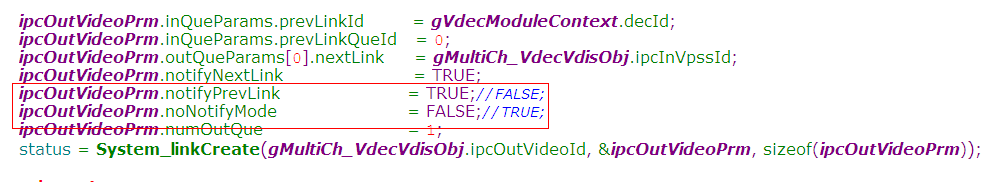

             //ipcOutVideo_link
        ipcOutVideoPrm.inQueParams.prevLinkId       = gVdecModuleContext.decId;
        ipcOutVideoPrm.inQueParams.prevLinkQueId    = 0;
        ipcOutVideoPrm.outQueParams[0].nextLink     = gMultiCh_VdecVdisObj.ipcInVpssId;
        ipcOutVideoPrm.notifyNextLink               = TRUE;
        ipcOutVideoPrm.notifyPrevLink               = FALSE;
        ipcOutVideoPrm.noNotifyMode                 = TRUE;
        ipcOutVideoPrm.numOutQue                    = 1;
        status = System_linkCreate(gMultiCh_VdecVdisObj.ipcOutVideoId, &ipcOutVideoPrm, sizeof(ipcOutVideoPrm));
              //ipcInVpss_Link
        ipcInVpssPrm.inQueParams.prevLinkId    =  ipcOutVideoId;
        ipcInVpssPrm.inQueParams.prevLinkQueId = 0;
        ipcInVpssPrm.notifyNextLink            = TRUE;
        ipcInVpssPrm.notifyPrevLink            = TRUE;
        ipcInVpssPrm.numOutQue                 = 1;
        ipcInVpssPrm.outQueParams[0].nextLink  = mergeId;
        System_linkCreate(ipcInVpssId , &ipcInVpssPrm , sizeof(ipcInVpssPrm));
       //merge_Link
        mergePrm.numInQue                       = 2;
        mergePrm.inQueParams[0].prevLinkId      = ipcInVpssId;
        mergePrm.inQueParams[0].prevLinkQueId   = 0;
        mergePrm.inQueParams[1].prevLinkId      =  gVcapModuleContext.captureId;
        mergePrm.inQueParams[1].prevLinkQueId   = 0;
        mergePrm.outQueParams.nextLink          =  gVdisModuleContext.swMsId[0];
        mergePrm.notifyNextLink                 = TRUE;
        System_linkCreate(mergeId   , &mergePrm  , sizeof(mergePrm));
        //swms_Link
        swMsPrm[0].numSwMsInst                 = 2;
        swMsPrm[0].swMsInstStartWin[0]         = 0;
        swMsPrm[0].swMsInstStartWin[1]         = 16;
        swMsPrm[1].numSwMsInst                 = swMsPrm[0].numSwMsInst;
        swMsPrm[1].swMsInstStartWin[0]         = swMsPrm[0].swMsInstStartWin[0];
        swMsPrm[1].swMsInstStartWin[1]         = swMsPrm[0].swMsInstStartWin[1];
        swMsPrm[0].inQueParams.prevLinkId      =  mergeId;
        swMsPrm[0].inQueParams.prevLinkQueId   = 0;
        swMsPrm[0].outQueParams.nextLink       = gVdisModuleContext.displayId[0];
        swMsPrm[0].maxInputQueLen              = SYSTEM_SW_MS_INVALID_INPUT_QUE_LEN;
        swMsPrm[0].maxOutRes                       = gVdisModuleContext.vdisConfig.deviceParams[VDIS_DEV_HDMI].resolution;
        swMsPrm[0].enableLayoutGridDraw        = TRUE;
        MultiCh_swMsGetDefaultLayoutPrm(0, &swMsPrm[0], FALSE);
        System_linkCreate(gVdisModuleContext.swMsId[0]  , &swMsPrm[0], sizeof(swMsPrm[0]));
        //dis_Link
        displayPrm[0].inQueParams[0].prevLinkId = gVdisModuleContext.swMsId[0] ;
        displayPrm[0].displayRes                = vdisParams.deviceParams[0].resolution;
        System_linkCreate(gVdisModuleContext.displayId[0], &displayPrm[0], sizeof(displayPrm[0]));

  • Below code is wrong.
    It should be
        ipcOutVideoPrm.notifyPrevLink               = TRUE;
        ipcOutVideoPrm.noNotifyMode                 = FALSE;
    I don't see any avsync configuration in swms link. Pls share the swms avsync link configuration.
    Also share logs of Vsys_printDetailedStatistics and Vsys_printBufferStatistics.
  • Hi, Badri, Thanks for your responses. I have modified the wrong code.
    about avsync configuration in swms link, add the funcation:
    static  Void mulich_vdec_vdis_set_avsync_prm(AvsyncLink_LinkSynchConfigParams *avsyncPrm,
                                                                                            UInt32 swMsIdx,                      VDIS_DEV vdDevId);
        But, Wrong again!!
      add  Vsys_printDetailedStatistics()      and         Vsys_printBufferStatistics();

  • There is some issue in you application code that is connecting captureLink to nextLink which is mergeLink. No buffers are dequeued from the captureLink in the non-working case. Check this part.Mostly either nextLink/prevLink or prevLinkQueId is wrongly set
  • Hi Badri,
    thanks for your reply.These days , I check the code carefully,and no errors are found.
    The phenomenon still exists:
    Initialization decoding channel, I set the parameters(channel numbers =16    resolution=720*576 ).when staring ,no video(from capture) displays on  Monitor .but when I set (channel numbers=2  resolution = 720*576), the video(from capture) displays OK! or I set (decode channel numbers =16,resolution =176*144 ) ,that is also OK!
     the following is about my links (modified code):
    //Cap_Link
    capturePrm.numBufsPerCh = 0;
    capturePrm.numExtraBufs = 0;
    capturePrm.maxBlindAreasPerCh = 0;
    capturePrm.overrideNumBufsInInstPrms = 0;
    // setting VIP0
    pCaptureInstPrm->videoCaptureMode = SYSTEM_CAPT_VIDEO_CAPTURE_MODE_SINGLE_CH_NON_MUX_DISCRETE_SYNC_ACTVID_VSYNC;
    pCaptureInstPrm->videoIfMode = SYSTEM_CAPT_VIDEO_IF_MODE_16BIT;
    pCaptureInstPrm->inScanFormat = SYSTEM_SF_PROGRESSIVE;
    /* Assign the sysLink ID*/
    gVdecModuleContext.ipcBitsOutHLOSId = SYSTEM_HOST_LINK_ID_IPC_BITS_OUT_0;
    gVdecModuleContext.ipcBitsInRTOSId = SYSTEM_VIDEO_LINK_ID_IPC_BITS_IN_0;
    gVdecModuleContext.decId = SYSTEM_LINK_ID_VDEC_0;
    gMultiCh_VdecVdisObj.ipcOutVideoId = SYSTEM_VIDEO_LINK_ID_IPC_OUT_M3_0;
    gMultiCh_VdecVdisObj.ipcInVpssId = SYSTEM_VPSS_LINK_ID_IPC_IN_M3_0;
    for (i=0; i<ipcBitsOutHostPrm.inQueInfo.numCh; i++)
    /* Set the BitsIn Link parameters of Video M3 */
    for (i=0; i<gVdecModuleContext.vdecConfig.numChn; i++)
    decPrm.chCreateParams[i].numBufPerCh = gVdecModuleContext.vdecConfig.decChannelParams[i].numBufPerCh;
    decPrm.chCreateParams[i].displayDelay = gVdecModuleContext.vdecConfig.decChannelParams[i].displayDelay;
    decPrm.chCreateParams[i].dpbBufSizeInFrames = IH264VDEC_DPB_NUMFRAMES_AUTO;
    //ipcInVpss_Link
    //merge_Link
    //swms_Link
    swMsPrm[0].initOutRes = VSYS_STD_1080P_60;
    swMsPrm[0].enableOuputDup = TRUE;
    swMsPrm[0].enableProcessTieWithDisplay = TRUE;
    swMsPrm[0].outputBufModified = TRUE;
    swMsPrm[0].numOutBuf = 4;
    swMsPrm[0].maxOutRes = VSYS_STD_1080P_60;
    swMsPrm[0].lineSkipMode = FALSE;
    //dis_Link
    DisplayLink_CreateParams_Init(&displayPrm[0]);
    displayPrm[0].inQueParams[0].prevLinkQueId = 0;
    displayPrm[0].displayRes = VSYS_STD_1080P_60;
