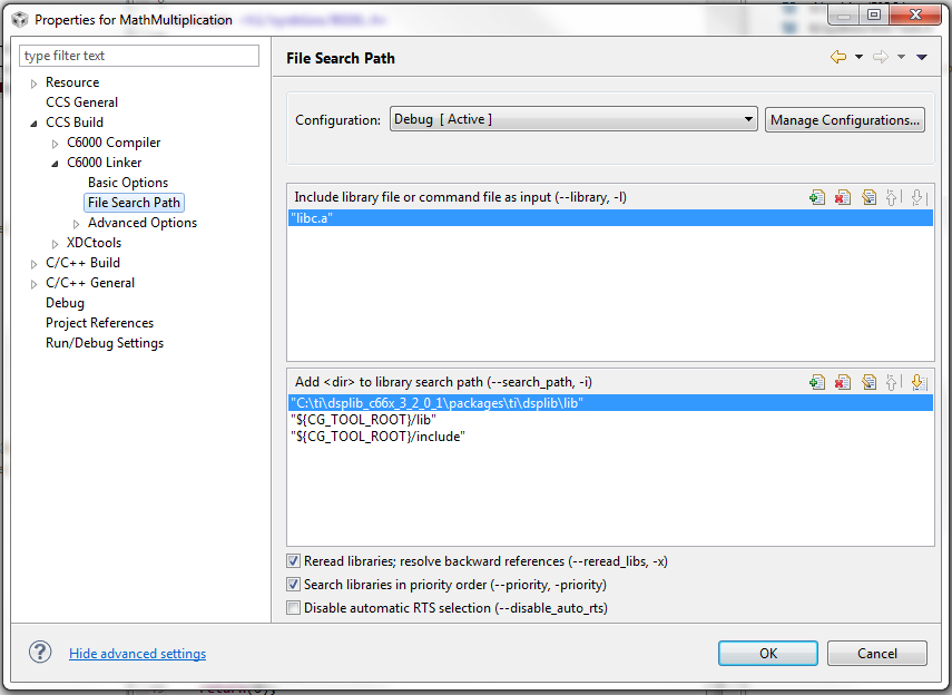

  • Thanks for the answer.
    I tried to follow your advice but I think I missing something. The result of adding the path for the dsplib is the same as before. This is how it looks like the libraries I am using. Do I miss soemthing else?
  • .. you need to add the library itself as well in the upper part of the window. The name of the lib is:
    dsplib.a66
    Kind regards,
    one and zero
  • Thanks. I solved the problem
