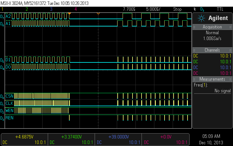

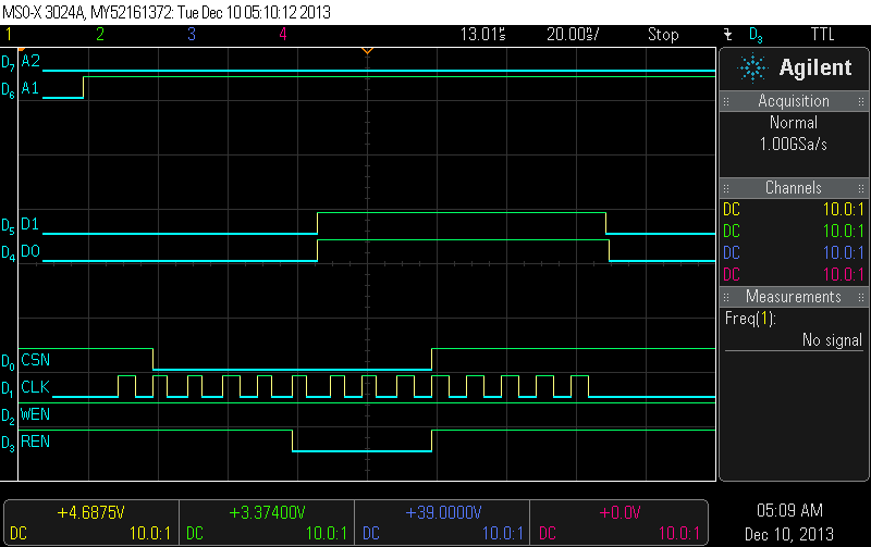

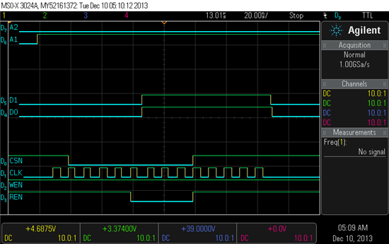

I try connect a beaglebone revA5 to a FPGA, to do so I use the AM335x GPMC in 16b non mux synchronous NOR mode. On the oscilloscope Write access works, read access seems also OK, but on processor side I always read zeros. If I try with this in asynchronous mode it works except for the first read.

I attached some scope captures, there is a big delay between the first read and the second one is it normal?
On this one the Data stay high while I get clk but it's not due to the FPGA, the output enable is directly connected to an outbuff oen which is asynchronous.
  • Hi Alexis,
    Check that you have receiver enabled (RXenable) in the pinmux for GPMC_CLK. This is necessary because the clock is taken from the pin for input retiming.
  • Hello Biser,
    Thank you, It was this, I saw yesterday on the forum this issue and I try to set the bit 5 (RXEN) of the gpmc_clk pinmux register from my C code with no effect. The weird thing is that I can't write this register as root in user space but through /sys/kernel/debug/omap_mux/gpmc_clk it works! My mistake was that I didn't check if this bit was really writen.
    Alexis.
