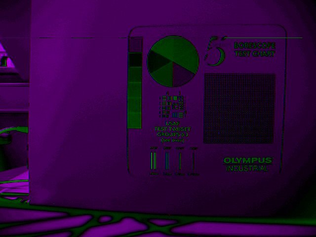

for my project I wrote a kernel module, which connects OMAP's ISP and DISPC to generate a video stream.
I get very strange artifacts in some pictures and I hope to get some new ideas for a solution.
My module reserves several frame buffers and handles ISP IRQ VDINT0 at the last line (line 480 when the vertical resolution is 480).
The handler writes to ISP register CCDC_SDR_ADDR the new buffer address (say buffer 1) and writes to the DISPC register DISPC_VID1_BA0 the address of the current buffer (lets say buffer 0).

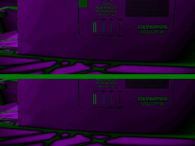

But somehow I do get a lot of pictures in my stream which are sometimes cut in half, sometimes a line is missing, or an extra line appears in the picture and so on.
To see these strange effects I saved three buffers as jpeg image files (sorry for the weird colors, but for now I am only processing luminance data).
Can someone tell me what is going on in my stream?

original (good) image:
cut image:

  • Sebastian,
    Make sure that you trigger the GOLCD bit (or GODIG if using the TV output) to ensure that the BA0 register write is copied to the controller.
    Note, the update will occur during the vertical blanking of the output. This really means that you should have three buffers in your cyclic buffer management (more does not give any additional benefit, less means you will get more stutter and/or tearing).
    You should write to the BA register with the address of the input buffer you have just completed reading and not the one you are about to write. (You are probably doing this, but I just want to make sure).
    If this does not help then we can try some tests to see if it is an input issue or an output issue.
    BR,
    Steve
  • Hi Steve,
    thank you for the quick answer. Well you are right.
    Setting the GOLCD bit did solve most of my tearing problem. Now the DISPC gets the latest buffer and the frame delay is down to 1~2 frames, and thats just fine.
