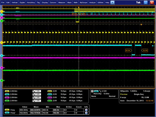

  • Sounds very strange to me. Can you probe the MDIO to check clock frequency and whether the PHY is actually outputting all F's? I can see no reason why detection should function in u-boot and not in kernel. Can you check if your MDIO pinmux does not get overwritten during kernel startup?
  • Hi Biser,
    On the scope, we are seeing a clock frequency somewhere around 460kHz. We are seeing the polling loop as noted in this thread: http://e2e.ti.com/support/arm/sitara_arm/f/791/t/304929.aspx Which makes it difficult to tell if we are actually accessing the phy or not.
    What I can tell you is that via some debugging mechanisms including toggling a GPIO while we are doing the access, is that we are currently only seeing the repeating pattern of accesses from the constant polling loop. We DO NOT see any additional accesses on the MDIO bus, so it seems likely that the phy isn't being queried at all to return this data, and that the Fs are happening because no query is actually done.
    When looking at the pin muxing to see if it's getting overwritten, I am seeing that the values for MDIO and MDC are both set to 0x30. According to the TRM, this means pad pullup/pulldown enabled, pullup selected, input enabled. Which matches the AM335X_PIN_INPUT_PULLUP define that I'm using on both these pins - so my pin-muxing seems to be working correctly.
    Any other things we can try? Why wouldn't we be seeing our requests go out over MDIO if our pin muxing is correct?
    By the way, we do see the PHYs respond to the automatic polling loop that is happening - it looks like over the range of all addresses, 2 of them (probably addresses 0 and 3, where our PHYs are, but it's hard to tell) are responding to the query. We can tell because these two have a different bit pattern from the rest of the polling loop, and there is data in the reply instead of the line staying high. So it really seems like the PHYs are out there and working.
  • This scope shot shows the GPIO pin (green) going low during our call to mdiobus_read, but you can see in the un-zoomed portion at the top the rapid polling loop is not interrupted by any outside accesses.
    You can also see that right after the GPIO goes low, we do get a response from a PHY, but this appears to be part of the normal loop as it is not the right address (0) that we put the GPIO toggle on. Later on in the un-zoomed portion of the image, toward the right side, you can see that the polling loop again hits addresses 0 and 3, and gets responses for each.

  • Hi Benjamin,
    Can you post what each channel captures on your scope?
  • Hi Biser,
    Our scope-shot is labeled, but it may not be immediately obvious. The labels are visible in the top-left of the screenshot. Yellow is MDC, blue is MDIO, pink is the Ethernet Reset line which holds our PHY in reset when it is low, and green is the GPIO line which indicates when we are entering the section of code that is supposedly polling PHY address 0.
    Also in things that may not be immediately obvious, the top fifth or so of the screenshot is the zoomed-out view where you can see the entire capture, and the lower 4/5 or so is the zoomed-in portion where you can see the majority of the action play out.
    The zoomed-out view is probably required for understanding the view of the constant polling loop.
    Ben

  • Hi Ben,
    I saw the labels now. Well, it seems to me that you are actually getting response on addresses 0 and 3 (at least there are two longer frames, separated by two short, and that pattern is repeating every 32 frames). So I think everything is fine on the hardware side. It has to be a software issue.

  • Biser,
    Here is our capture of the preamble happening. Screenshot is labeled like the previous one.
    Ben
