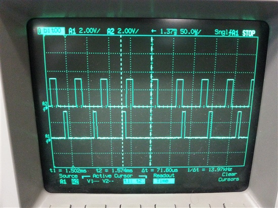

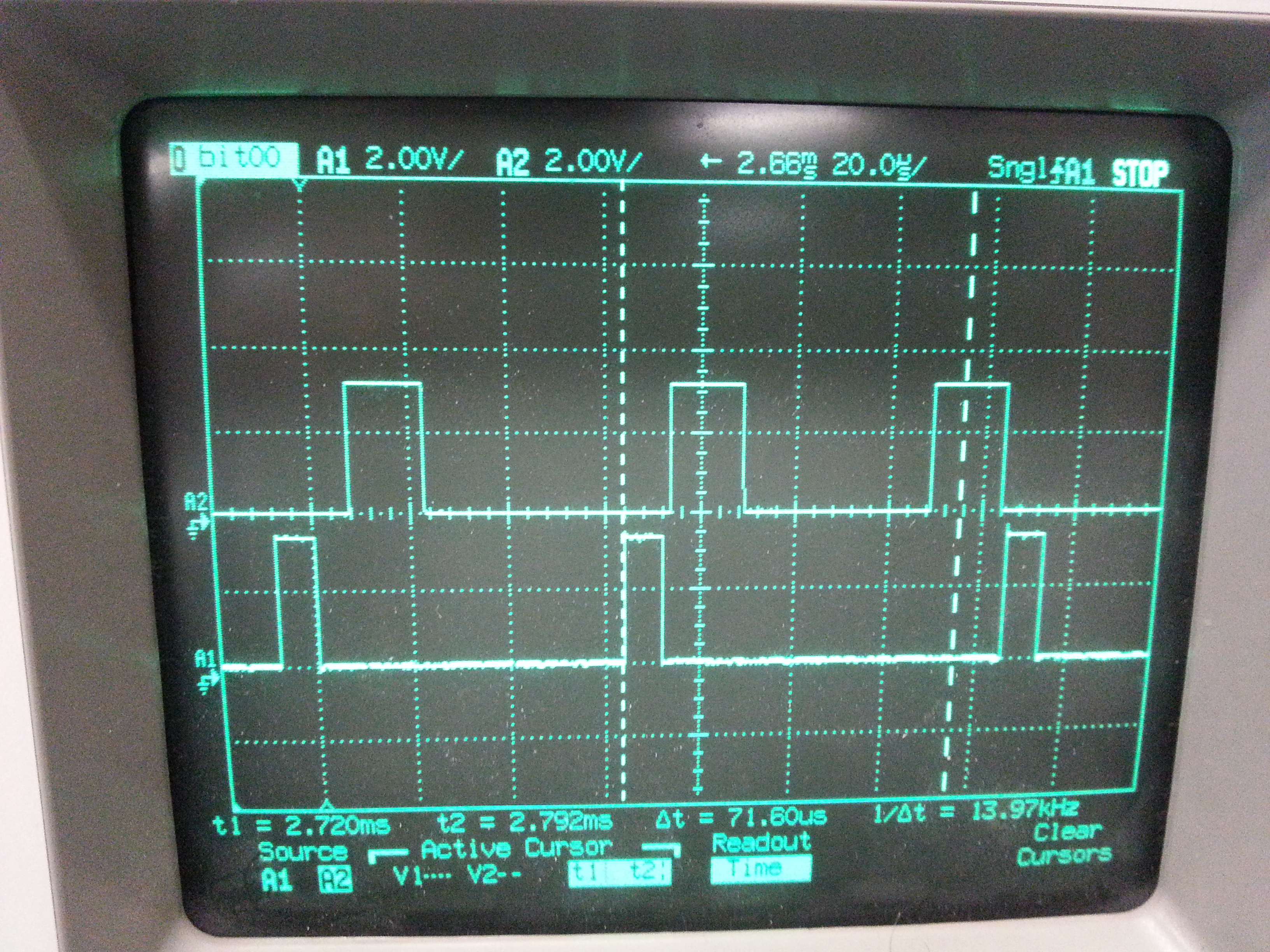

  • I've added some o-scope captures to illustrate the problem.
    In the attached images, the top pulses represent a GPIO pin being toggled in timer 1. The bottom pulses represent a GPIO pin being toggled in timer 0.
    Timer 0 is setup to fire every 71.6 uS. Timer 1 is setup to fire every 60.5uS.
    "Expected Behavior.jpg" illustrates a scenario where timer 0 (bottom waveform) can be seen executing every 71.6uS. It can be seen that timer 1 executes and blocks (a little longer than the 1 uS I listed in the comments of the first post), causing a delay in the 3rd firing of timer 0, as expected. Based on the way the ISR is written, this shows that the timer 1 routine executed, the ISR exited, and was immediately entered again to service the pending timer0 interrupt.
    "Missed Interrupt.jpg" illustrates a scenario where both timer 0 (bottom waveform) and timer 1 are both executing. It can be seen that the 4th pulse of timer 0 is missing. If one looks at the cursors, it can be seen that the missed firing of timer 0 occurred at the exact same time when timer 1 begins
    execution. I would expect a similar result as shown in "expected behavoir.jpg" where timer 1 would first execute, the ISR would exit and be re-entered,and then the timer 0 code would be executed.
    I've also made observations where timer 1 is missed when the timer 0 interrupt fires off at roughly the same time.
    It appears the ISR is not being re-entered when timers 0 & 1 expire simultaneously.
    I'm hoping I'm doing something wrong with my ISR setup, not some low level time bug within the DSP. I see the TINT bit of IFR0 is self clearing when the ISR is entered. I would think this bit needs to set again if two timer interrupts go off at the same time in order for the ISR to be re-entered.
    Expected Behavior:
    Missed Interrupt:

  • The first step in the execution of the SIR is to read the Timer Interrupt Aggregation Flag Register (TIAFR, 0x1C14) and check bits 0 and 1 to determine source of the timer interrupt .
    In regards to your second question, I set a breakpoint at the first line of the timer ISR and observed the INTM bit set to one. This confirms SWPU073. Upon leaving the ISR and returning execution to the main loop, I observed the INTM bit restored to 0.
    However, I was able to fix my problem by changing the way I write a 1 to the TIAFR to clear the respective flag.
    The previous code (as shown above) used a logical OR to set the bit (TIAFR |= 0x01). Upon looking into the CSL code, I observed the value use to set the respective bit was directly written into the register (TIAFR = 0x01;). It's somewhat counter intuitive to me to overwrite a register value instead of ORing in the bit I want to set, but I understand I can get away with it since this register is not effected with writes of zero to any bit.
    I guess there was some kind of timing issue going on since the OR line of code causes a read and write of the memory location while the write is just that, a direct write.
    Any thoughts why I can't get away with the OR to set that bit?
  • Below is where I think the issue could be:
     Assuming that the first step in your ISR you read value of 0x01 (register_value) from TIAFR , then started executing first if condition but before you clearing the Timer0 interrupt , say Timer1 Interrupt occurred. In this case OR operation would clear both the interrupt. So the second if condition will not execute and also no interrupt gets generated as your INTM bit will be set inside an ISR.
    • So from my point of view, right way to implement is not to use OR function but just clear that particular interrupt. Also you could configure INTM bit to 0 when you enter interrupt.
    Hope the above explanation justifies the issue you had faced.
  • Indeed it does. The OR condition works 99% of the time, it doesn't work in that small window where the DSP sets the bit between the ISR firing and the time I perform the OR.
    Thank you again for your diligence in following through with this question!
