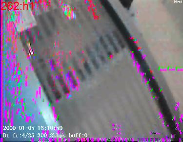

    But when I move camera, the frame UV data will be wrong,
    I suspect that there is not enough time to do 704x576 frame. right?

  • Sorry
    In static status, the display'd frame is ok. But when I move camera, the picture is like:
    so I think that usecase config is correct, right?
  • Does statistics print show full fps (all links running fine) on static camera case?
