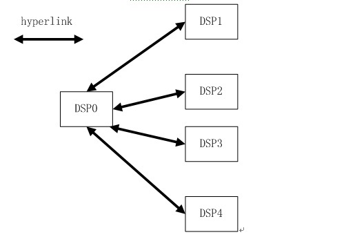

How to deal with the situation in which one DSP connects with muti-DSPs(three or more) via hyperlink?
Other Parts Discussed in Thread: TCI6638K2K
Hi,all
How to solve the problem about hyperlink between muti-DSPs like below?Supposed that DSP is C6678.
Supposed that DSP0 connects DSP1,DSP2,DSP3,DSP4 via hyperlink .
Supposed that DSP0 want to access the DDR address range of the four DSPs(DSP1,DSP2.DSP3,DSP4) which is from 0x8000 0000.
As I understand,I must do like this:
1.
Hyperlink Maps    DSP1’s DDR  address range (0x8000 0000)  to DSP0’s hyperlink data space (supposed it  is  0x4000 0000)
2.
Hyperlink  Maps    DSP2’s DDR  address range (0x8000 0000)  to DSP0’s hyperlink data space (supposed it  is  0x4100 0000)
 3.
Hyperlink  Maps    DSP3’s DDR  address range (0x8000 0000)  to DSP0’s hyperlink data space (supposed it  is  0x4200 0000)
4.
Hyperlink  Maps    DSP4’s DDR  address range (0x8000 0000)  to DSP0’s hyperlink data space (supposed it  is  0x4300 0000)
But that is out of theory .For practice how can you make sure that the address of 0x4000 0000 is translated to
DSP1’s DDR address range (0x8000 0000) not DSP2,not DSP3 and not DSP4?How would you make sure that ?
The reason I want to ask like above that I meet similarly problem in my system.In my system, DSP0 maybe send data to DSP1 and DSP2 or maybe more (to DSP3 DSP4) via hyperlink.So I must create a address translation table who can tell that which of hyperlink address space (from 0x4000 0000 to 0x4FFF FFFF) can mapped to which of DSP’s DDR space(such as DSP1 DSP2 DSP3 DSP4)?That’s what I want to know.
  • The 6678 only have 1 Hyperlink port, from chip DSP0, you can only connect to another DSP chip, NOT multiples.
    Regards, Eric
  • Hyperlink is a pt-to-pt.  Even with Keystone II devices that have multiple ports, you can setup a TX memory translation window for each port, but you can't go directly from one port to the other.  You must write to memory somewhere on the device and have the CPU write out the data to the other port in that case.  There are no Hyperlink switches available today, though you could potentially develop one in an FPGA for example.
    Travis

  • As stated above, you can only connect one DSP Hyperlink port to one other DSP Hyplerlink port.  It is a pt-to-pt connection.
    If I'm am not understanding your question, please clarify.
    Travis

  • Steven,
    C6678 only has 1 Hyperlink port, so you can only connect to another DSP.
    K2H has 2 Hyperlink ports, you can connect port 0 to DSP 1 and port1 to DSP 2.
    Regards, Eric

    Yes.  Pt-to-Pt just means that each port can only connect to one other device.  No multidrop.  All SerDes based interfaces are like this.
    Travis
