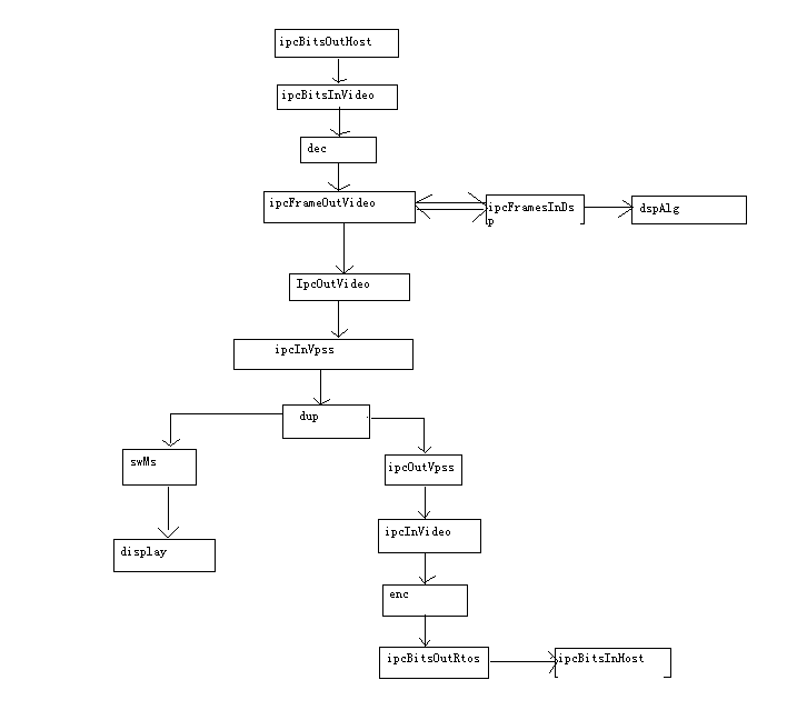

Hi,everyone:
       I created a usecase , it's structure is: read_local_file -> ipcBitsOutHost -> ipcBitsInVideo -> dec -> ipcFrameOutVideo ->IpcOutVideo ->IpcInVpss -> dup ->IpcOutVpss -> IpcInVideo -> enc -> ipcBitsOutRtos -> ipcBitsInHost -> write_to_local
this is one way , the other way is followed after dup: dup -> swMS -> display
the output on display looks normally. but there are only 6 frames can be writen to local. I traced the source codes, I found the empty buf in encLink does not release. Once the 6 buf be used ,it can not alloc any new empty que buf, so the encLink stops work. I also found the release of the empty buf is done by encLink's next link,ipcBitsOutRtos.
the function is :IpcBitsOutLink_releaseBitBufs(IpcBitsOutLink_Obj * pObj) in /dvr_rdk/mcfw/src_bios6/links_common/ipcBitsOut/ipcBitsOutLink_tsk.c
in this function, it call ListMP_getHead, but it return NULL. the loop breaks, the empty does not be released.
I wonder the reason and how to reslove this problem
thanks!
shen
  • Does ipcBitsInHost receive any buffer at all?
    Can you disable notifyMode & check if it works?
  • Attach your usecase file where you are creating and connecting links and logs of Vsys_printDetailedStatistics and Vsys_printBufferStatistics invoked 3 times with 1 min interval.
  • Hi, Sivagamy
        thanks for your reply. IpcBitsInHost recieves data of 6 frames. But I am afraid that the 6 frames I received are not correct, because they are different with the first 6 frames of the source h264 file.
        And I don't understand how to disable notifyMode,do you mean something like "System_ipcSendNotify()"?

        my usecase file:

        gMultiCh_VdecVdisObj.ipcOutVpssId    = SYSTEM_VPSS_LINK_ID_IPC_OUT_M3_0;
        gMultiCh_VdecVdisObj.ipcInVideoId  =  SYSTEM_VIDEO_LINK_ID_IPC_IN_M3_0;
        gVencModuleContext.ipcBitsOutRTOSId = SYSTEM_VIDEO_LINK_ID_IPC_BITS_OUT_0;
        gVencModuleContext.ipcBitsInHLOSId   = SYSTEM_HOST_LINK_ID_IPC_BITS_IN_0;
        if(enableGrpx)
            // GRPX is enabled in Vdis_start() based on the link ID set here
            gVdisModuleContext.grpxId[0]    = SYSTEM_LINK_ID_GRPX_0;
    #if defined(TI_814X_BUILD) || defined(TI_8107_BUILD)
            gVdisModuleContext.grpxId[1]    = SYSTEM_LINK_ID_INVALID;
    #else
            gVdisModuleContext.grpxId[1]    = SYSTEM_LINK_ID_GRPX_1;
    #endif
        ipcBitsOutHostPrm.baseCreateParams.outQueParams[0].nextLink= gVdecModuleContext.ipcBitsInRTOSId;
        ipcBitsOutHostPrm.baseCreateParams.notifyNextLink       = FALSE;
        ipcBitsOutHostPrm.baseCreateParams.notifyPrevLink       = FALSE;
        ipcBitsOutHostPrm.baseCreateParams.noNotifyMode         = TRUE;
        ipcBitsOutHostPrm.baseCreateParams.numOutQue            = 1;
        ipcBitsOutHostPrm.inQueInfo.numCh                       = gVdecModuleContext.vdecConfig.numChn;
        ipcBitsOutHostPrm.bufPoolPerCh                          = TRUE;
        for (i=0; i<ipcBitsOutHostPrm.inQueInfo.numCh; i++)
            ipcBitsOutHostPrm.inQueInfo.chInfo[i].width =
                gVdecModuleContext.vdecConfig.decChannelParams[i].maxVideoWidth;
            ipcBitsOutHostPrm.inQueInfo.chInfo[i].height =
                gVdecModuleContext.vdecConfig.decChannelParams[i].maxVideoHeight;
            ipcBitsOutHostPrm.inQueInfo.chInfo[i].scanFormat =
                SYSTEM_SF_PROGRESSIVE;
            ipcBitsOutHostPrm.inQueInfo.chInfo[i].bufType        = 0; // NOT USED
            ipcBitsOutHostPrm.inQueInfo.chInfo[i].codingformat   = 0; // NOT USED
            ipcBitsOutHostPrm.inQueInfo.chInfo[i].dataFormat     = 0; // NOT USED
            ipcBitsOutHostPrm.inQueInfo.chInfo[i].memType        = 0; // NOT USED
            ipcBitsOutHostPrm.inQueInfo.chInfo[i].startX         = 0; // NOT USED
            ipcBitsOutHostPrm.inQueInfo.chInfo[i].startY         = 0; // NOT USED
            ipcBitsOutHostPrm.inQueInfo.chInfo[i].pitch[0]       = 0; // NOT USED
            ipcBitsOutHostPrm.inQueInfo.chInfo[i].pitch[1]       = 0; // NOT USED
            ipcBitsOutHostPrm.inQueInfo.chInfo[i].pitch[2]       = 0; // NOT USED
            ipcBitsOutHostPrm.numBufPerCh[i] = 6;
        ipcBitsInVideoPrm.baseCreateParams.inQueParams.prevLinkId    = gVdecModuleContext.ipcBitsOutHLOSId;
        ipcBitsInVideoPrm.baseCreateParams.inQueParams.prevLinkQueId = 0;
        ipcBitsInVideoPrm.baseCreateParams.outQueParams[0].nextLink  = gVdecModuleContext.decId;
        ipcBitsInVideoPrm.baseCreateParams.noNotifyMode              = TRUE;
        ipcBitsInVideoPrm.baseCreateParams.notifyNextLink            = TRUE;
        ipcBitsInVideoPrm.baseCreateParams.notifyPrevLink            = FALSE;
        ipcBitsInVideoPrm.baseCreateParams.numOutQue                 = 1;
            if(gVdecModuleContext.vdecConfig.decChannelParams[i].isCodec == VDEC_CHN_H264)
                decPrm.chCreateParams[i].format                 = IVIDEO_H264HP;
            else if(gVdecModuleContext.vdecConfig.decChannelParams[i].isCodec == VDEC_CHN_MPEG4)
                decPrm.chCreateParams[i].format                 = IVIDEO_MPEG4ASP;
            else if(gVdecModuleContext.vdecConfig.decChannelParams[i].isCodec == VDEC_CHN_MJPEG)
                decPrm.chCreateParams[i].format                 = IVIDEO_MJPEG;
            decPrm.chCreateParams[i].numBufPerCh
                             = gVdecModuleContext.vdecConfig.decChannelParams[i].numBufPerCh;
            decPrm.chCreateParams[i].profile                = IH264VDEC_PROFILE_ANY;
            decPrm.chCreateParams[i].displayDelay
                             = gVdecModuleContext.vdecConfig.decChannelParams[i].displayDelay;
            decPrm.chCreateParams[i].dpbBufSizeInFrames = IH264VDEC_DPB_NUMFRAMES_AUTO;
            decPrm.chCreateParams[i].fieldMergeDecodeEnable = FALSE;
            decPrm.chCreateParams[i].targetMaxWidth  =
                ipcBitsOutHostPrm.inQueInfo.chInfo[i].width;
            decPrm.chCreateParams[i].targetMaxHeight =
                ipcBitsOutHostPrm.inQueInfo.chInfo[i].height;
            decPrm.chCreateParams[i].defaultDynamicParams.targetFrameRate =
                gVdecModuleContext.vdecConfig.decChannelParams[i].dynamicParam.frameRate;
            decPrm.chCreateParams[i].defaultDynamicParams.targetBitRate =
                gVdecModuleContext.vdecConfig.decChannelParams[i].dynamicParam.targetBitRate;
        decPrm.inQueParams.prevLinkId       = gVdecModuleContext.ipcBitsInRTOSId;
        decPrm.inQueParams.prevLinkQueId    = 0;
        decPrm.outQueParams.nextLink        = gVcapModuleContext.ipcFramesOutVideoId;
        decPrm.tilerEnable                  = tilerEnable;
        ipcFramesOutVideoPrm.baseCreateParams.inQueParams.prevLinkId    = gVdecModuleContext.decId;
        ipcFramesOutVideoPrm.baseCreateParams.inQueParams.prevLinkQueId = 0;
        ipcFramesOutVideoPrm.baseCreateParams.notifyPrevLink = FALSE;
        ipcFramesOutVideoPrm.baseCreateParams.numOutQue                 = 1;
        ipcFramesOutVideoPrm.baseCreateParams.outQueParams[0].nextLink     = gVdisModuleContext.ipcOutVideoId;
        ipcFramesOutVideoPrm.baseCreateParams.notifyNextLink            = TRUE;
        ipcFramesOutVideoPrm.baseCreateParams.processLink = gVcapModuleContext.ipcFramesInDspId[0];
        ipcFramesOutVideoPrm.baseCreateParams.notifyProcessLink = TRUE;
        ipcFramesOutVideoPrm.baseCreateParams.noNotifyMode = FALSE;
        ipcFramesInDspPrm.baseCreateParams.inQueParams.prevLinkId = gVcapModuleContext.ipcFramesOutVideoId;
        ipcFramesInDspPrm.baseCreateParams.inQueParams.prevLinkQueId = 0;
        ipcFramesInDspPrm.baseCreateParams.numOutQue   = 1;
        ipcFramesInDspPrm.baseCreateParams.outQueParams[0].nextLink = gVcapModuleContext.dspAlgId[0];
        ipcFramesInDspPrm.baseCreateParams.notifyPrevLink = TRUE;
        ipcFramesInDspPrm.baseCreateParams.notifyNextLink = TRUE;
        ipcFramesInDspPrm.baseCreateParams.noNotifyMode   = FALSE;
        dspAlgPrm.inQueParams.prevLinkId = gVcapModuleContext.ipcFramesInDspId[0];
        dspAlgPrm.inQueParams.prevLinkQueId = 0;
        ipcOutVideoPrm.inQueParams.prevLinkId    = gVcapModuleContext.ipcFramesOutVideoId;
        ipcOutVideoPrm.inQueParams.prevLinkQueId = 0;
        ipcOutVideoPrm.outQueParams[0].nextLink     = gMultiCh_VdecVdisObj.ipcInVpssId;
        ipcOutVideoPrm.notifyNextLink            = TRUE;
        ipcOutVideoPrm.notifyPrevLink            = TRUE;
        ipcOutVideoPrm.numOutQue                 = 1;
        ipcInVpssPrm.inQueParams.prevLinkId    = gVdisModuleContext.ipcOutVideoId;
        ipcInVpssPrm.inQueParams.prevLinkQueId = 0;
        ipcInVpssPrm.outQueParams[0].nextLink      = gMultiCh_VdecVdisObj.dupId;
        ipcInVpssPrm.notifyNextLink            = TRUE;
        ipcInVpssPrm.notifyPrevLink            = TRUE;
        ipcInVpssPrm.numOutQue                 = 1;
        dupPrm.inQueParams.prevLinkId         = gMultiCh_VdecVdisObj.ipcInVpssId;
        dupPrm.inQueParams.prevLinkQueId      = 0;
        dupPrm.numOutQue                      = 2;
        dupPrm.outQueParams[0].nextLink       = gVdisModuleContext.swMsId[0];
        dupPrm.outQueParams[1].nextLink       = gMultiCh_VdecVdisObj.ipcOutVpssId;
        dupPrm.notifyNextLink                 = TRUE;
        ipcOutVpssPrm.inQueParams.prevLinkId    = gMultiCh_VdecVdisObj.dupId;
        ipcOutVpssPrm.inQueParams.prevLinkQueId = 1;
        ipcOutVpssPrm.numOutQue                 = 1;
        ipcOutVpssPrm.outQueParams[0].nextLink  = gMultiCh_VdecVdisObj.ipcInVideoId;
        ipcOutVpssPrm.notifyNextLink            = FALSE;
        ipcOutVpssPrm.notifyPrevLink            = TRUE;
        ipcOutVpssPrm.noNotifyMode              = TRUE;
        ipcInVideoPrm.inQueParams.prevLinkId    = gMultiCh_VdecVdisObj.ipcOutVpssId;
        ipcInVideoPrm.inQueParams.prevLinkQueId = 0;
        ipcInVideoPrm.numOutQue                 = 1;
        ipcInVideoPrm.outQueParams[0].nextLink     = gVencModuleContext.encId;
        ipcInVideoPrm.notifyNextLink            = TRUE;
        ipcInVideoPrm.notifyPrevLink            = FALSE;
        ipcInVideoPrm.noNotifyMode              = TRUE;
        encPrm.numBufPerCh[0] = 6; //D1
     //   encPrm.numBufPerCh[1] = 4; //CIF
            EncLink_ChCreateParams *pLinkChPrm;
            EncLink_ChDynamicParams *pLinkDynPrm;
            VENC_CHN_DYNAMIC_PARAM_S *pDynPrm;
            VENC_CHN_PARAMS_S *pChPrm;
            //Primary Stream Params - D1
            for (i=0; i<gVencModuleContext.vencConfig.numPrimaryChn; i++)
                pLinkChPrm  = &encPrm.chCreateParams[i];
                pLinkDynPrm = &pLinkChPrm->defaultDynamicParams;
                pChPrm      = &gVencModuleContext.vencConfig.encChannelParams[i];
                pDynPrm     = &pChPrm->dynamicParam;
                pLinkChPrm->format                  = IVIDEO_H264HP;
                pLinkChPrm->profile                 = gVencModuleContext.vencConfig.h264Profile[i];
                pLinkChPrm->dataLayout              = IVIDEO_FIELD_SEPARATED;
                pLinkChPrm->fieldMergeEncodeEnable  = FALSE;
                pLinkChPrm->enableAnalyticinfo      = pChPrm->enableAnalyticinfo;
                pLinkChPrm->enableWaterMarking      = pChPrm->enableWaterMarking;
                pLinkChPrm->maxBitRate              = pChPrm->maxBitRate;
                pLinkChPrm->encodingPreset          = pChPrm->encodingPreset;
                pLinkChPrm->rateControlPreset       = pChPrm->rcType;
                pLinkChPrm->enableSVCExtensionFlag  = pChPrm->enableSVCExtensionFlag;
                pLinkChPrm->numTemporalLayer        = pChPrm->numTemporalLayer;
                pLinkDynPrm->intraFrameInterval     = pDynPrm->intraFrameInterval;
                pLinkDynPrm->targetBitRate          = pDynPrm->targetBitRate;
                pLinkDynPrm->interFrameInterval     = 1;
                pLinkDynPrm->mvAccuracy             = IVIDENC2_MOTIONVECTOR_QUARTERPEL;
                pLinkDynPrm->inputFrameRate         = pDynPrm->inputFrameRate;
                pLinkDynPrm->rcAlg                  = pDynPrm->rcAlg;
                pLinkDynPrm->qpMin                  = pDynPrm->qpMin;
                pLinkDynPrm->qpMax                  = pDynPrm->qpMax;
                pLinkDynPrm->qpInit                 = pDynPrm->qpInit;
                pLinkDynPrm->vbrDuration            = pDynPrm->vbrDuration;
                pLinkDynPrm->vbrSensitivity         = pDynPrm->vbrSensitivity;
            if (gVsysModuleContext.vsysConfig.enableSecondaryOut == TRUE)
                for (i=gVencModuleContext.vencConfig.numPrimaryChn, j=VENC_PRIMARY_CHANNELS;
                      i<(gVencModuleContext.vencConfig.numPrimaryChn
                               + gVencModuleContext.vencConfig.numSecondaryChn);
                        i++, j++)
                    pChPrm      = &gVencModuleContext.vencConfig.encChannelParams[j];
        encPrm.inQueParams.prevLinkId   = gMultiCh_VdecVdisObj.ipcInVideoId;
        encPrm.inQueParams.prevLinkQueId= 0;
        encPrm.outQueParams.nextLink    = gVencModuleContext.ipcBitsOutRTOSId;
        ipcBitsOutVideoPrm.baseCreateParams.inQueParams.prevLinkId    = gVencModuleContext.encId;
        ipcBitsOutVideoPrm.baseCreateParams.inQueParams.prevLinkQueId = 0;
        ipcBitsOutVideoPrm.baseCreateParams.numOutQue                 = 1;
        ipcBitsOutVideoPrm.baseCreateParams.outQueParams[0].nextLink   = gVencModuleContext.ipcBitsInHLOSId;
        ipcBitsInHostPrm.baseCreateParams.inQueParams.prevLinkId    = gVencModuleContext.ipcBitsOutRTOSId;
        ipcBitsInHostPrm.baseCreateParams.inQueParams.prevLinkQueId = 0;
        ipcBitsInHostPrm.baseCreateParams.numOutQue                 = 1;
        ipcBitsInHostPrm.baseCreateParams.outQueParams[0].nextLink   = SYSTEM_LINK_ID_INVALID;
        MultiCh_ipcBitsInitCreateParams_BitsInHLOS(&ipcBitsInHostPrm);
        swMsPrm[0].swMsInstId[0]        = SYSTEM_SW_MS_SC_INST_VIP1_SC;
        swMsPrm[0].swMsInstId[1]        = SYSTEM_SW_MS_SC_INST_DEI_SC_NO_DEI;
        swMsPrm[0].numSwMsInst          = 2;
        swMsPrm[0].swMsInstStartWin[0]  = 0;
        swMsPrm[0].swMsInstStartWin[1]  = 16;
        swMsPrm[0].enableProcessTieWithDisplay = TRUE;
        for(i=0; i<1; i++)
            VDIS_DEV vdDevId = VDIS_DEV_HDMI;
            swMsPrm[i].inQueParams.prevLinkId     = gMultiCh_VdecVdisObj.dupId;
            swMsPrm[i].inQueParams.prevLinkQueId  = i;
            swMsPrm[i].outQueParams.nextLink      = gVdisModuleContext.displayId[i];
            swMsPrm[i].numOutBuf                 = MULTICH_NUM_SWMS_MAX_BUFFERS;
            swMsPrm[i].maxInputQueLen             = SYSTEM_SW_MS_INVALID_INPUT_QUE_LEN;
            if (i == 0)
                swMsPrm[i].maxOutRes              = VSYS_STD_1080P_60;
                swMsPrm[i].initOutRes             = gVdisModuleContext.vdisConfig.deviceParams[VDIS_DEV_HDMI].resolution;
            else if (i == 1)
                vdDevId = VDIS_DEV_SD;
                swMsPrm[i].maxOutRes              = VSYS_STD_PAL;
                swMsPrm[i].outQueParams.nextLink  = SYSTEM_LINK_ID_DISPLAY_2;
                swMsPrm[i].initOutRes             = gVdisModuleContext.vdisConfig.deviceParams[VDIS_DEV_SD].resolution;
    #else
                vdDevId = VDIS_DEV_DVO2;
                swMsPrm[i].initOutRes             = gVdisModuleContext.vdisConfig.deviceParams[VDIS_DEV_DVO2].resolution;
    #endif
            if(tilerEnable)
                swMsPrm[i].lineSkipMode           = FALSE;

        System_linkCreate(gVdecModuleContext.ipcBitsOutHLOSId,&ipcBitsOutHostPrm,sizeof(ipcBitsOutHostPrm));
        System_linkCreate(gVdecModuleContext.ipcBitsInRTOSId,&ipcBitsInVideoPrm,sizeof(ipcBitsInVideoPrm));
        System_linkCreate(gVdecModuleContext.decId, &decPrm, sizeof(decPrm));
        System_linkCreate(gVcapModuleContext.ipcFramesOutVideoId, &ipcFramesOutVideoPrm, sizeof(ipcFramesOutVideoPrm));
        System_linkCreate(gVcapModuleContext.ipcFramesInDspId[0], &ipcFramesInDspPrm, sizeof(ipcFramesInDspPrm));
        System_linkCreate(gVcapModuleContext.dspAlgId[0] , &dspAlgPrm, sizeof(dspAlgPrm));
        System_linkCreate(gVdisModuleContext.ipcOutVideoId, &ipcOutVideoPrm, sizeof(ipcOutVideoPrm));    //gVdisModuleContext
        System_linkCreate(gMultiCh_VdecVdisObj.ipcInVpssId  , &ipcInVpssPrm, sizeof(ipcInVpssPrm));
        System_linkCreate(gMultiCh_VdecVdisObj.dupId     , &dupPrm    , sizeof(dupPrm));
        System_linkCreate(gMultiCh_VdecVdisObj.ipcOutVpssId, &ipcOutVpssPrm, sizeof(ipcOutVpssPrm));  //1
        System_linkCreate(gMultiCh_VdecVdisObj.ipcInVideoId, &ipcInVideoPrm, sizeof(ipcInVideoPrm));
        System_linkCreate(gVencModuleContext.encId, &encPrm, sizeof(encPrm));
        System_linkCreate(gVencModuleContext.ipcBitsOutRTOSId, &ipcBitsOutVideoPrm, sizeof(ipcBitsOutVideoPrm));
        System_linkCreate(gVencModuleContext.ipcBitsInHLOSId, &ipcBitsInHostPrm, sizeof(ipcBitsInHostPrm));
        System_linkCreate(gVdisModuleContext.swMsId[0]  , &swMsPrm[0], sizeof(swMsPrm[0]));
        System_linkCreate(gVdisModuleContext.displayId[0], &displayPrm[0], sizeof(displayPrm[0]));

        the logs :
     [m3video]  24596: IPC_FRAMES_OUT   : Received 1 framebufs !!!
     [m3video]  24632: IPC_FRAMES_OUT   : Received 1 framebufs !!!
     [m3video]  24664: IPC_FRAMES_OUT   : Received 1 framebufs !!!
     [m3video]  24696: IPC_FRAMES_OUT   : Received 1 framebufs !!!
     [m3video]  24732: IPC_FRAMES_OUT   : Received 1 framebufs !!!
     [m3video]  24764: IPC_FRAMES_OUT   : Received 1 framebufs !!!
     [m3video]  24796: IPC_FRAMES_OUT   : Received 1 framebufs !!!
     [m3video]  24832: IPC_FRAMES_OUT   : Received 1 framebufs !!!
     [m3video]  24864: IPC_FRAMES_OUT   : Received 1 framebufs !!!
     [m3video]  24896: IPC_FRAMES_OUT   : Received 1 framebufs !!!
     [m3video]  24932: IPC_FRAMES_OUT   : Received 1 framebufs !!!
     [m3video]  24964: IPC_FRAMES_OUT   : Received 1 framebufs !!!
     [m3video]  24996: IPC_FRAMES_OUT   : Received 1 framebufs !!!
    After I can see the video on monitor, the program print the above log only.
    the video dispaly on monitor is right.
    best regards!
    shen
  • I dont see your application receiving bitstream from encoder and freeing it back.Make sure you have a application thread that does
    Venc_getBitstreamBuffer
    Venc_releaseBitstreamBuffer
    Refer example code in  /dvr_rdk/demos/mcfw_api_demos/mcfw_demo/demo_vcap_venc_vdis_bits_wr.c
