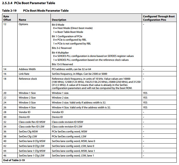

looking at the new bootlader User's Guide SPRUGY5C it seems that the boot parameter table functionality has disappeared.
While in SPRUGY5A the boot parameter table functionality is explained in detail. See e.g. Section 3.4, Table 3-12 PCIe Boot Parameter Table.
Does this mean C6678 PG2.0 Boot ROM does not support PCIe Boot Parameter Table anymore or does still work like described in SPRUGY5A?

    The boot parameter table functionality is now documented in the TMS320C6678 device datasheet: http://www.ti.com/lit/gpn/tms320c6678.
    The PCIe boot parameter table in particular is in section 2.5.3.4 and table 2-19.

  • Bernd,
    one and zero is correct. As you can see from the PCIe boot parameter table only the window size is configurable through the configuration pins (AKA boot strap pins). This means that on a PCIe first stage boot this is the only portion of the boot parameter table that you can alter before the PCIe boot begins.
    If you would like to modify the vendor ID or the device ID using the boot parameter table you would need to use a different boot mode to transfer in the PCIe boot parameter table with the configurations that you would like and then re-enter the boot process to use the new table.
    Here is the PCIe boot parameter table from the datasheet:

    I believe (Jason please confirm my theory since I'm not 100% sure) you only need the I2C Boot Parameter Table boot mode as described in SPRUGY5C:
    "3.7.2.3 Loading a Boot Parameter Table
    In this boot mode, the RBL provides the option to load only a boot parameter table.
    This option is useful if the user wants to load a new boot parameter table for booting in
    a different boot mode. The user will be setting the I2C to master mode."
    You basically load a PCIe boot parameter table which then will trigger the PCIe boot from RBL. The format of the boot parameter table is in the datasheet.
    Table 2-15 Boot Parameter Table Common Parameters
    Table 2-19 PCIe Boot Mode Parameter Table
    How to best generate this table I'm actually also not sure.My guess would be you just use an Editor. The table needs to be in big endian format.
    You can use EEPROM Writer Utility to program the Boot Parameter Table into the EEPROM. How the utility works is described in the readme.txt found in the MCSDK (C:\ti\mcsdk_2_01_02_06\tools\writer\eeprom).

  • Bernd,
    Sorry for my confusion, I assumed that you wanted to set the VENDOR_DEVICE_ID register which can be set by the PCIe boot parameter table (but not through the boot strap pins for PCIe). I now understand that you would like to set the SUBSYS_VNDR_ID register instead which cannot be set through the PCIe boot parameter table.
    In this case, I think that it would be easiest to perform a multistage boot. The first stage of the boot would load a small program image (through any peripheral, most likely I2C in your case). This first stage program image can be as simple as a single C source file with only a main function that would be responsible for:
    1. Setting the SUBSYS_VNDR_ID register to the desired values, along with any other registers
    2. Overwriting the existing boot parameter table in the L2 with a PCIe boot parameter table
      1. The boot parameter table for the 6678 device is stored in the L2 at address 0x00873680 as defined by table 2-3 in the data manual
    3. Branch to the boot re-entry address which is 0x20B00008
    Using the boot re-entry address allows us to run the bootloader again with whatever boot parameter table currently exists in the L2 at address 0x00873680. Since your first stage program will define the entire boot parameter table found in the L2 then you can alter any of the PCIe boot parameter table values that you want, not just the bootstrap-able values.
