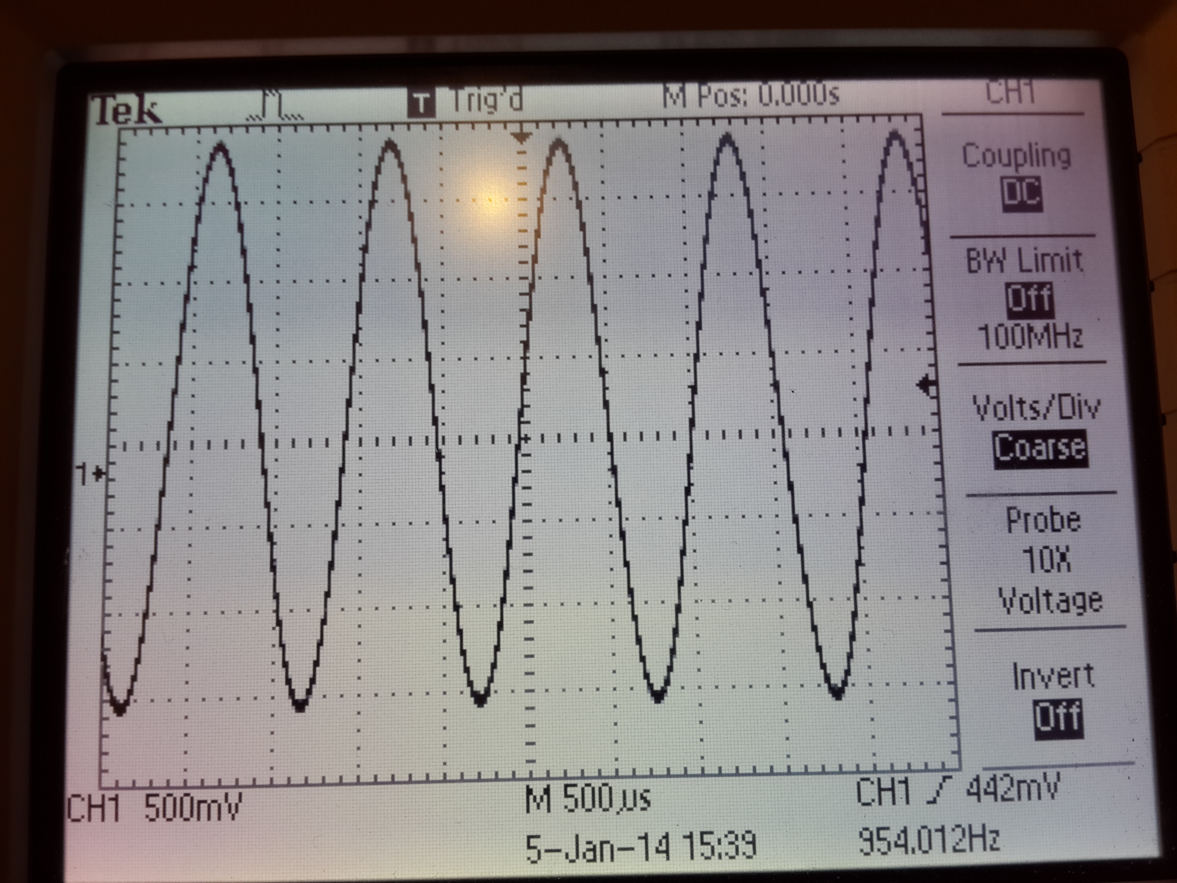

    1. The output is so noisy. The SNR is less than 50 db !!!! wow. It is so disappointing.The codec datasheet claims that its SNR is 90db. By the way, I read the codec registers. They say "all things are ok"
    There’s no such thing as “all things are OK.”  If he has the AIC3106 configured one way and the McASP on L137 set up another way (differing bit depth, right justified vs left justified, different clock polarity, etc), then it’s not OK.  He should grab a scope and look at the bit clock vs frame sync vs data at the input and output of McASP and see what’s different, for starters.
    2. The output level is very low. I changed the setting by "amixer" function and I was successful in heightening it to 2 volts (pick to pick). How can I restore the output to 3.3 volts?
    I don’t know what “amixer” is.  If it’s a volume function on the DSP/ARM, then someone who knows the software can help him.  If it’s a function to directly change the analog output level, then it’s a codec question and they need to help him with it.  But if he’s seeing low output level, first step is to figure out if the ARM side code is applying any attenuation.  That shouldn’t be hard to find.
    3.The codec claims that it supports 32 and 24 bit format. However, when I set the format to 24-bit the data is not really 24-bit. It seems to be 16-bit. I tested it.
    Sounds like a question for the codec team, but I would ask: what data?  The data going from AIC to L137?  Or the data going from L137 back to ADC?

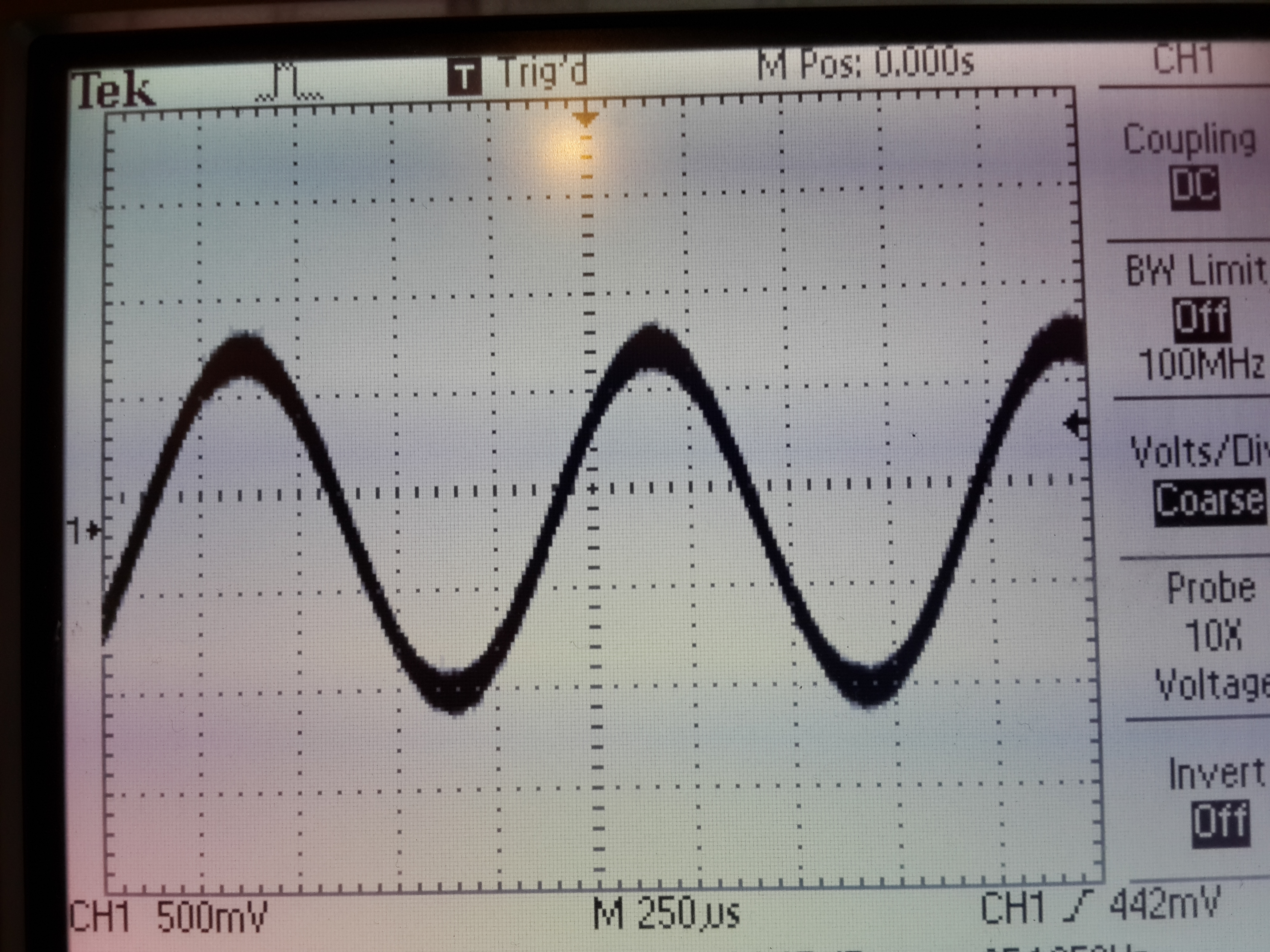

    I used a signal generator to generate a sinusoid signal shown in Figure 1. It is clean. Then, I used following instruction that captures from line in and plays on line out (ALSA driver):
    arecord -d 20 -D 'hw:0,0' -r 96000 -f S32_LE -c 2 | aplay -D 'hw:0,0' -c 2
    I saw the output by a scope. Figure 2 shows the result. The result is so noisy. Our analysis by Matlab shows that the SNR is about 50 db.
    Figure 1
    Figure 2
    We have bought Three OMAP-L137 boards. All have the same mistake.
